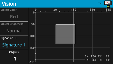

What does the vision dashboard show when your code is running ? It should see something like this (signature 1 is selected here)
If the dashboard does not show the object you are trying to detect, then tune the signature some more using the vision utility.
