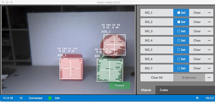

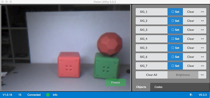

I’m not exactly sure what you are asking, however, vision sensor doesn’t really know anything about the shape on an object, it will just detect the color and then create a bounding box around it. For example, with this test scene
It can detect this.
The red ball and cube are both detected as color signature 1, but there’s really no way to know which is which from the results.
I haven’t used vision sensor in a while, forgot how bad the color is.
