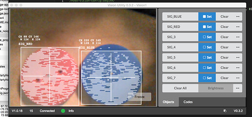

I have added a vision sensor to my robot and configured two color signature for red and blue balls. The next goal is to use the color signature to automatically sort balls to go to the tower or out the back of the robot. I assume you would the code would look something like this:
if(Vision.Sig1){
put balls into tower
}else if(Vision.Sig2){
send balls out the back
I don’t know what the arguments in the if/else statements would be so if someone could provide an example, your help would be much appreciated.

That’s completely wrong, getSignature does not tell you anything about objects. You need to use takeSnapshot. See the examples included with VEXcode, or perhaps search the forum, here is an old example (written for VCS but should still work).

you most likely do not want to be using color codes, just signatures (a color code is 2 or more adjacent color objects)
Do something like this.
int main() {
    int nObjects;
    while(1) {
      // Allow other tasks to run
      this_thread::sleep_for(10);
      nObjects = Vision1.takeSnapshot(SIG_BLUE);
      if( nObjects ) {
        Brain.Screen.printAt( 10, 10, "Blue found    ");
        // we found a blue object !
        continue;
      nObjects = Vision1.takeSnapshot(SIG_RED);
      if( nObjects ) {
        Brain.Screen.printAt( 10, 10, "Red found    ");
        // we found a red object
        continue;
      Brain.Screen.printAt( 10, 10, "Nothing found");
that’s assuming you have calibrated the vision sensor and named the two signatures SIG_RED and SIG_BLUE like this.
