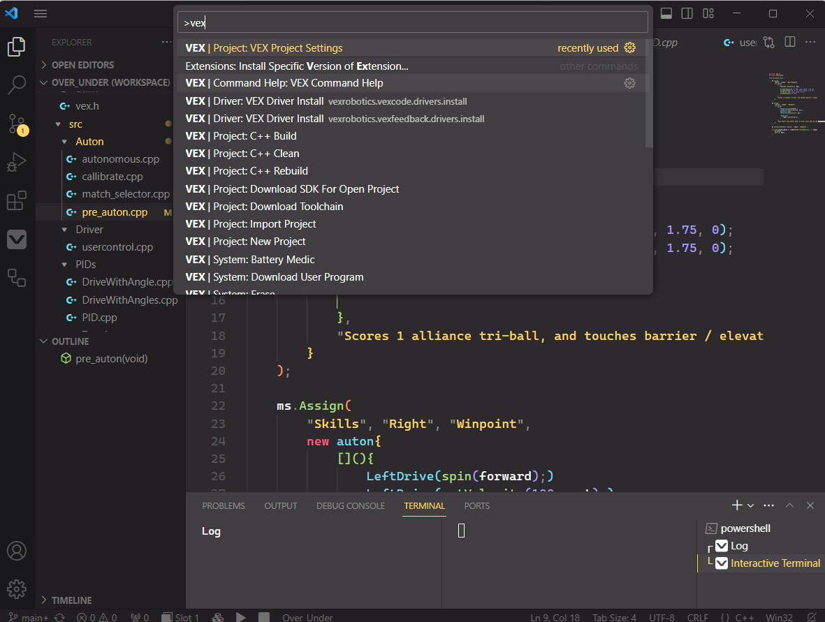

I am also unable to find the help menu that the VEXCode applications have. The api reference can be found here VEX Help
Open the command palate… (ctrl + shift + p) then search for vex command help:

Some help is integrated and accessed via the command pallette as Pi_way describes or right clicking on a function name and selecting from the contextual menu.
