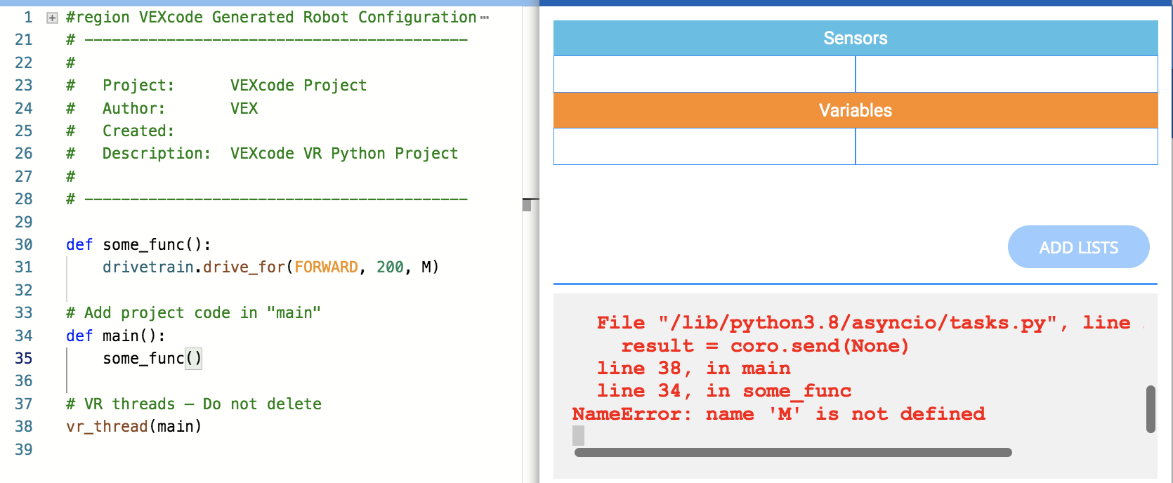

VR Call Trace Line Numbers Are Off By 3
It appears that the error message call trace line numbers are consistently off by 3.
For example:
(I know what the coding error is, this is intended to show the call trace.)
The call trace is a way of showing students how functions call functions, which call functions…
Is there a way to fix this off-by-3 in VEXcode VR?
The call trace should be lines 35 and 31…
Traceback (most recent call last):
  File "/lib/python3.8/asyncio/tasks.py", line 280, in __step
    result = coro.send(None)
  line 35, in main
  line 31, in some_func
NameError: name 'M' is not defined
