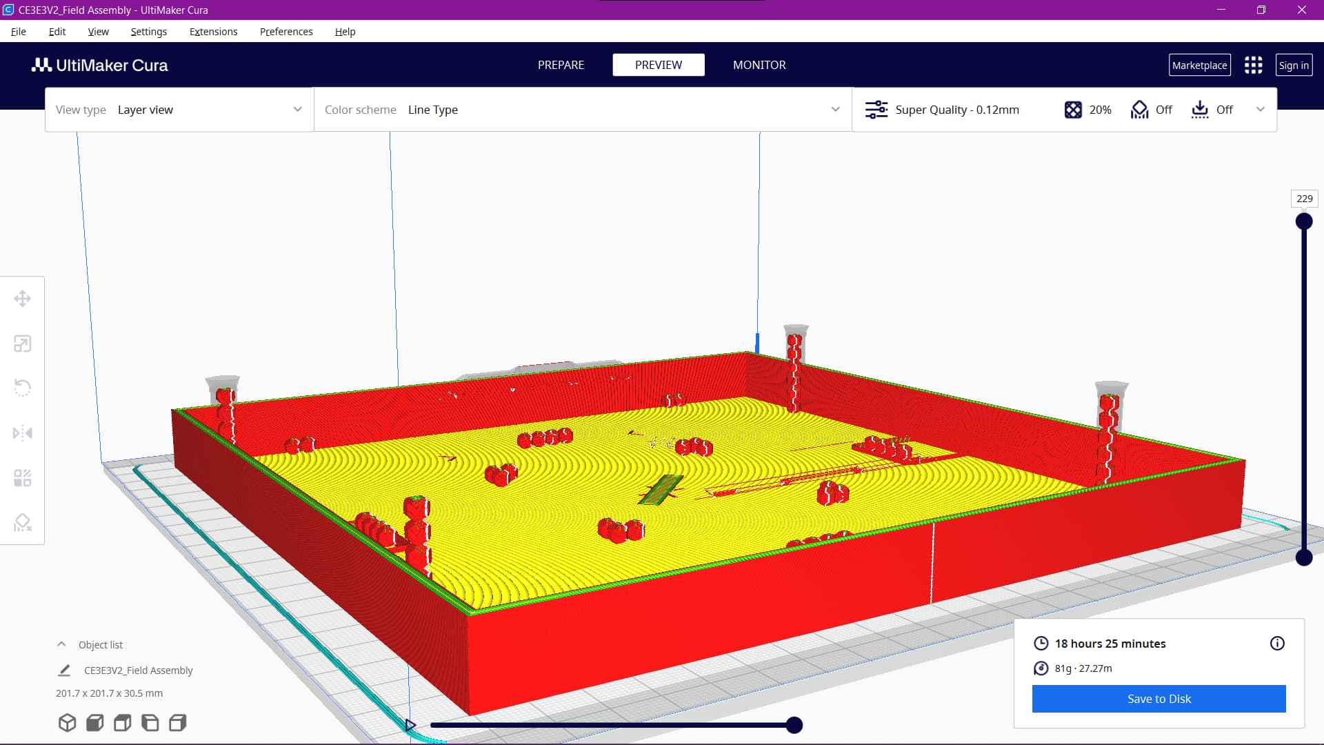

This is amazing, already a lot better than the one that vex distributed. I’ve been working on trying to 3D print that model for a while now and no matter how many times I repaired it and ran it through my slicer there were still mesh errors. It looks like your fixes to the floor tiles and walls have worked but some of the game elements still get ignored by the slicer. If you are able to fix those that would be great!
I’m working on re-modeling each individual part from scratch, which should fix the remaining issues. Once I’m done with all of the models I’ll make another post here. In the meantime, you can check the latest version of the workspace to check on the progress, as I add a new version each time I make a change.

Just finished remodeling everything by hand, should work now.
