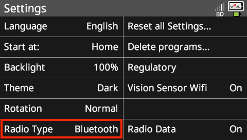

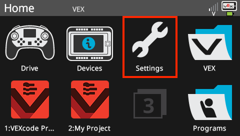

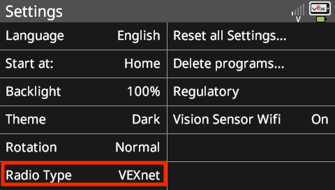

      • From the home screen select “Settings”

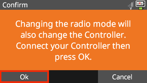

      • If the “Radio Type” box says “VEXnet” click the box to change it to “Bluetooth”
      • A confirmation dialog will be presented to verify your choice. Click “Ok” NOTE: You can tether your controller to the brain at this point and the brain will change the radio mode of your controller for you. But if you do not tether your controller at this step you can either tether it later or manually change the radio mode using the controller’s menu.
      • Once you click “Ok” verify your “Radio Type” now says “Bluetooth”
      • NOTE: You do NOT have to turn on “Radio Data” to use the controller in Bluetooth mode for your skills attempts.

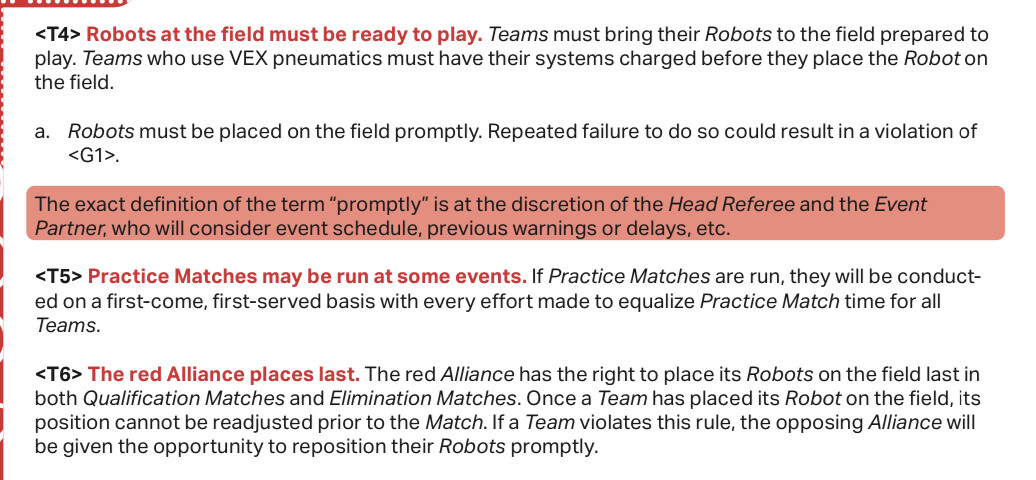

So just to be clear- I’m not going to get yelled at by a ref for trying to fix this issue after I’ve already set down my robot? The manual seems to say that once you have “placed” your robot you cannot move/touch it. the definition of placed is subjective but that is qna-type question. referring to T4 and T6:
Many teams are used to placing their robots on the field, and then turning the robot on after the controller has already been plugged in due to trying to prevent pneumatics from making any extra actuations and the battery running down. If I set up my auton and have my robot placed, and then proceed to discover the brain is not on VEXnet, are the field techs still able to help me/am I allowed to touch my brain for the sole purpose of doing this? Or is it too late?
I understand you may not have an answer, I am mostly asking an open-ended question to bring attention to a possibly overlooked topic. The rule has been interpreted in multiple different ways; for example, not being able to touch the robot after you let go of it. So it doesn’t have to just apply to turning on VEXnet on your brain. Again it might be best for this to be a qna question (I personally can’t but if someone wants to that could be helpful). The definition of what exactly “placed” means should probably be clarified.
edit: I realized the qna is closed. Point still stands, though.

All of the referees and techs will know that this situation will be different from other competitions and they will show grace being as that is the case. If you set your robot down and then plug into the field and get the radio error, they will allow you to change your radio mode so you can proceed. But with that being said, do your best to come prepared. This information will be discussed at the event with teams. I am sure it will come up in the drivers meeting as well as in inspection. That is also why we are posting about this now so we make sure everyone knows.
