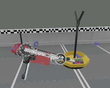

It seems like a really useful tool - once the bugs are out. And fun. But currently the physics are really buggy. Is there a way I can fix it on my end? I can imagine it being a super useful tool.
We’re working on improving physics, but keep in mind that the goal is not to be a “robot simulation” but rather a coding tool.
Meaning don’t expect 1-to-1 matching of the real world field, but we are doing out best to abide by the laws of physics :grin:
If you do find reproducible issues, using the feedback tool and including diagnostic data will help us troubleshoot and continue to improve over the coming weeks.
I find it doesn’t matter what I try to code, the robot will do really unpredictable things.
I’ll make sure to use the feedback tool more. :grinning_face_with_smiling_eyes:

The issue isn’t so much related “make the physics” work… it’s a few key issues that I’ll share to give you some insight:
  1. 100% pure physics would become processor intensive and would require “higher” end machines. We’ve set an internal mark to make sure our tools work reliably in school environments (low end computers, 5-7 year old computers, Chromebooks) to increase accessibility. We could make the game VERY pretty and simulate materials and real world physics, but then only about 1-2% of users could use it, and most schools don’t have those high end machines available.
  2. “Real” physics can present a level of unreliability and punishing difficulty, so we use the magic of video games in order to simply some engagements for repeatability to increase the enjoyment and success of the user. The objective is not to “make a game simulator”, it’s to make a tool to bring the game and coding experience to more people by increasing accessibility. We fully understand that “top end” teams might not even bother, but for a lot of teams this is a great way to get planning / strategy / coding experience early in the season.
  3. All of this is then compounded by exporting out our projects into a WebGL package, which takes your wonderfully working game and throws a lot of it out of the window. Processor and Memory limitations, browser threading limits, all of which make your gameplay scripts do completely unexpected things (and even crazier things with “real” physics after you’re getting 2 FPS…) . I would say that 40-50% of our development effort is playing the game in-browser to tweak and tune based on WebGL.
Then… you give it to users. Who do the kinds of things you didn’t test and now you have to improve your gameplay scripts to handle because the robot does crazy things now:
  • Placing a goal on one platform and then jumping off of the balanced platform to start working on the next goal
  • Climbing up the side of the platform (think where the pivot point is)
  • Pushing mobile goals into other mobile goals (think stacking mobile goals)
  • Pushing mobile goals via the back of the robot into scored positions
Soon we’ll be adding Python support to VRC Virtual Skills and will get to see what fun new “unexpected features” pop up as well :grinning: - hope this provides some insight into the development experience.
