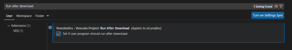

There is a user setting you can enable that will allow your program to run after it has been download.
Screenshot 2023-08-29 203855

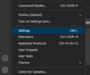

You can find this by:
  1. Clicking the gear in the bottom left hand corner of vscode:
    Screenshot 2023-08-29 204124
  2. Select “Settings” on the context menu that appears.

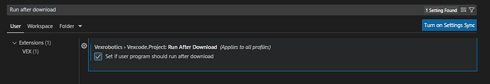

    Screenshot 2023-08-29 204243
  3. A settings page will appear. Search for “Run after download” and make sure this setting is enable.

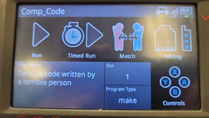

Just to clear up an confusion I’ll get pictures tomorrow. As far as errors I’m no longer getting any on the computer side. The download works and my code builds. A new (other than the original error code) issue has arrived where the computer or the brain may be downloading incorectly. Hopefully some pictures and screenshots can help.
On the Vex V5 brain when you download it will say project type: [Some project type here (generally C++)]. It is currently saying makefile. Now from my understanding make files can be run as they are used in the build process to give terminal outputs and help with compile path (Agian Idk make file). This would make sense that the brain doesn’t write a error like the memory permission error or not run at all because it can be executed. I can get pictures tomorrow morning when I go into our lab.

Here are the pictures.
