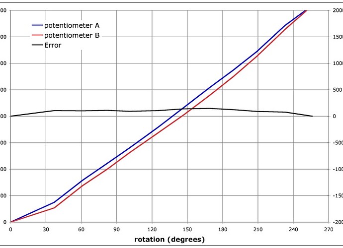

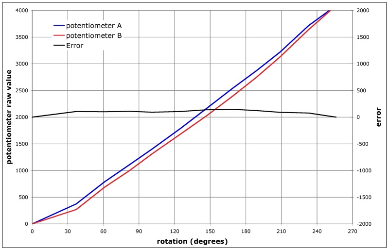

Pots should not drift. Seems like new experiments are needed, put two (or more) pots on a single axle and test to see if the values track. The absolute values will not be the same but the tracking error should be within 1 or 2 degrees I would think, a digital count difference of perhaps 30.
Did a quick test today, two pots on the same axle along with an encoder to measure angle. Potentiometer data was slightly filtered to remove noise. Here is a graph of the results. Useful range is probably about 200 degrees, maximum error within that range, after removing the fixed offset, was 36. That is, the error was +/- 36.
[ATTACH]6856[/ATTACH]
