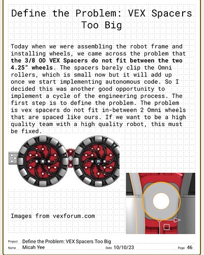

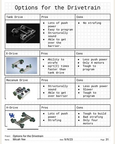

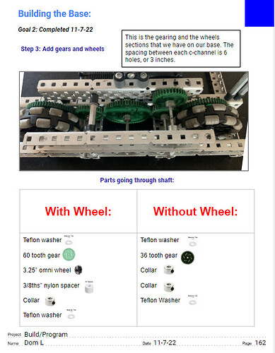

Example notebook page I wrote (this is from my notebook.)
Screenshot 2023-10-24 4.34.00 PM
Screenshot 2023-10-24 4.34.31 PM
I can tell you have put a lot of work into your entries. However, I have some tips. These are not meant to be insults, and I am not saying my notebook is perfect. My goal is for everyone to have a successful season.
Split it up. That paragraph at the top is monstrous. If I were a judge, I wouldn’t even touch it. Also, I see maybe 5 points in that paragraph that could use their own entry.
Give the judge what really matters. The judge doesn’t care what you did after you installed your motor caps. The judge is looking for the engineering process. That’s simply what the notebook is supposed to be.
Instead of telling the judge about every c-channel you install, tell the judge about how you plan to manage your resources. Go into detail about how you picked your drive gearing. Maybe show some math calculating the strength of your lift.

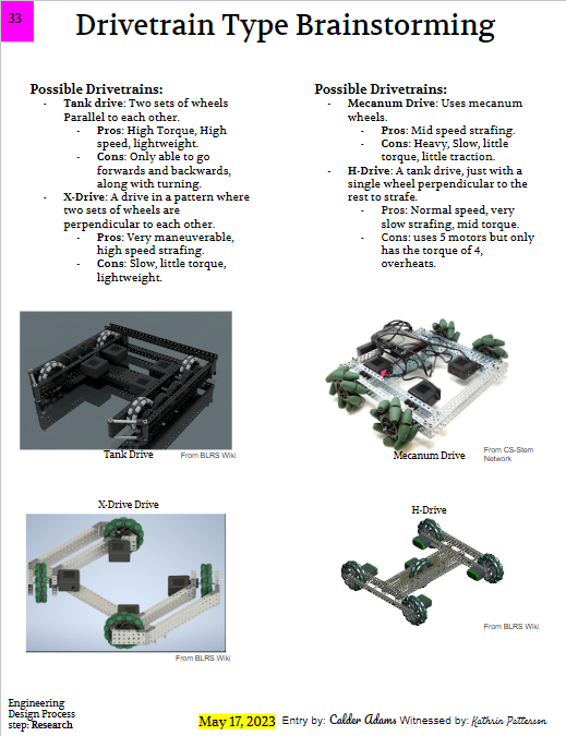

Here are some example pages from my notebook.
Thank you for opening this topic discussing notebooks and good luck in the rest of your season!
This is my Drivetrain Brainstorming Page, we use the same pictures!
We format differently but still get almost the same point across.
That’s hilarious! That is a good point that we format differently but we are both doing an engineering process cycle for our drivetrain. Also worth mentioning that using lots of pictures in your notebook is great because it makes the notebook less dense and easier for the judge to process. Also, a good resource is the engineering notebook rubric. That should be your main resource for notebooking as it tells you exactly what you are being scored on.

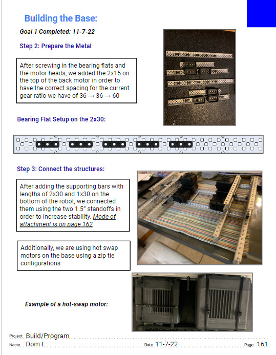

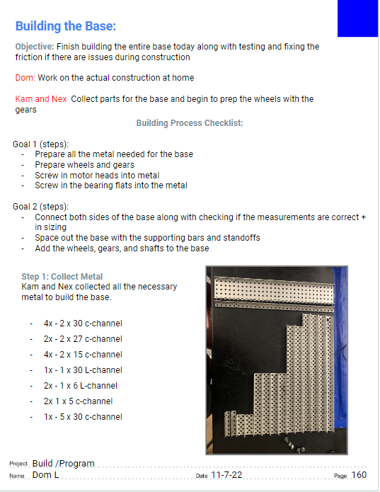

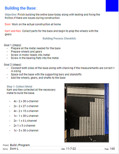

I both agree and disagree with your advice to @Rishabh_Jain24. You are absolutely correct that they should consider splitting things up, and avoid “walls of text” at all costs, but the rubric states:
This means, that there should be a lot of detail in build logs- enough that someone could recreate the robot from them. Below are some pages from one of my teams’ notebooks from last year showing one way that you can provide that degree of detail without having so many walls of text.
I agree, my teammate wrote that page and I will work with him to try to trim it down.
Absolutely. I do not mean to say cut down on the detail, I mean to say that you should use paragraph breaks, pictures, charts, tables, and maybe even videos instead of walls of text. Also maybe spit the entry into a couple of entries, like one for the drivetrain, one for the lift etc.
Im honored my jank cad made it into ur notebook :smile:
Who’s notebook had your cad?
Mine did apparently😊
