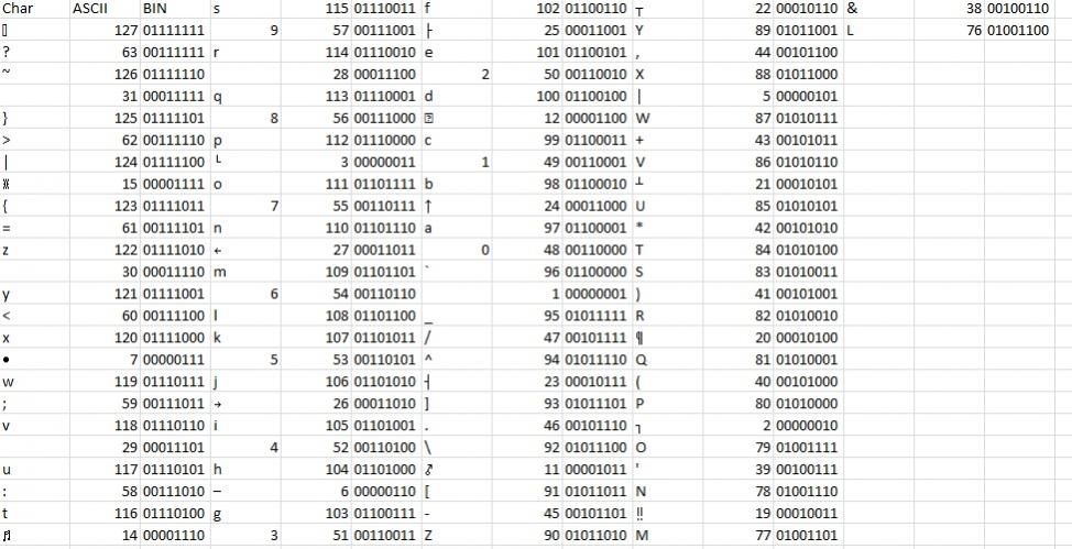

This is the data I got from printing all ascii characters
Code:
#pragma config(UART_Usage, UART1, uartUserControl, baudRate9600, IOPins, None, None)
		if (vexRT[Btn7D])
			for (int i=0; i<256; i++)
			sendChar(UART1, i);
			wait1Msec(50);
[ATTACH]7898[/ATTACH]
Note: LN feeds and returns are not included because they overwrote other characters

The voltages on the D9 connector are almost certainly outside the safe range for the Cortex serial port, as James points out. Not only are the voltage swings too large, they are also inverted (TTL serial uses non-inverted, and RS-232 serial uses inverted). This inversion is probably the reason you are getting gibberish. If you look at the table you posted, you can see it is receiving mostly 1’s at the beginning and ends up with mostly 0’s. It isn’t a perfect countdown because the start and stop bits are also inverted, which throws off the byte framing logic in the UART.
You must use a level shifter to get the signals into the proper voltage range and invert them.
