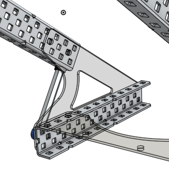

  1. CAD (custom parts)
    截圖 2023-03-26 下午4.53.48
  2. Building(Build Quality, still not very good but improve a lot)
  3. Programming(Design pattern, Code structure, lots of control algorithms, and build my own library for the first time)
