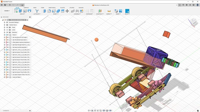

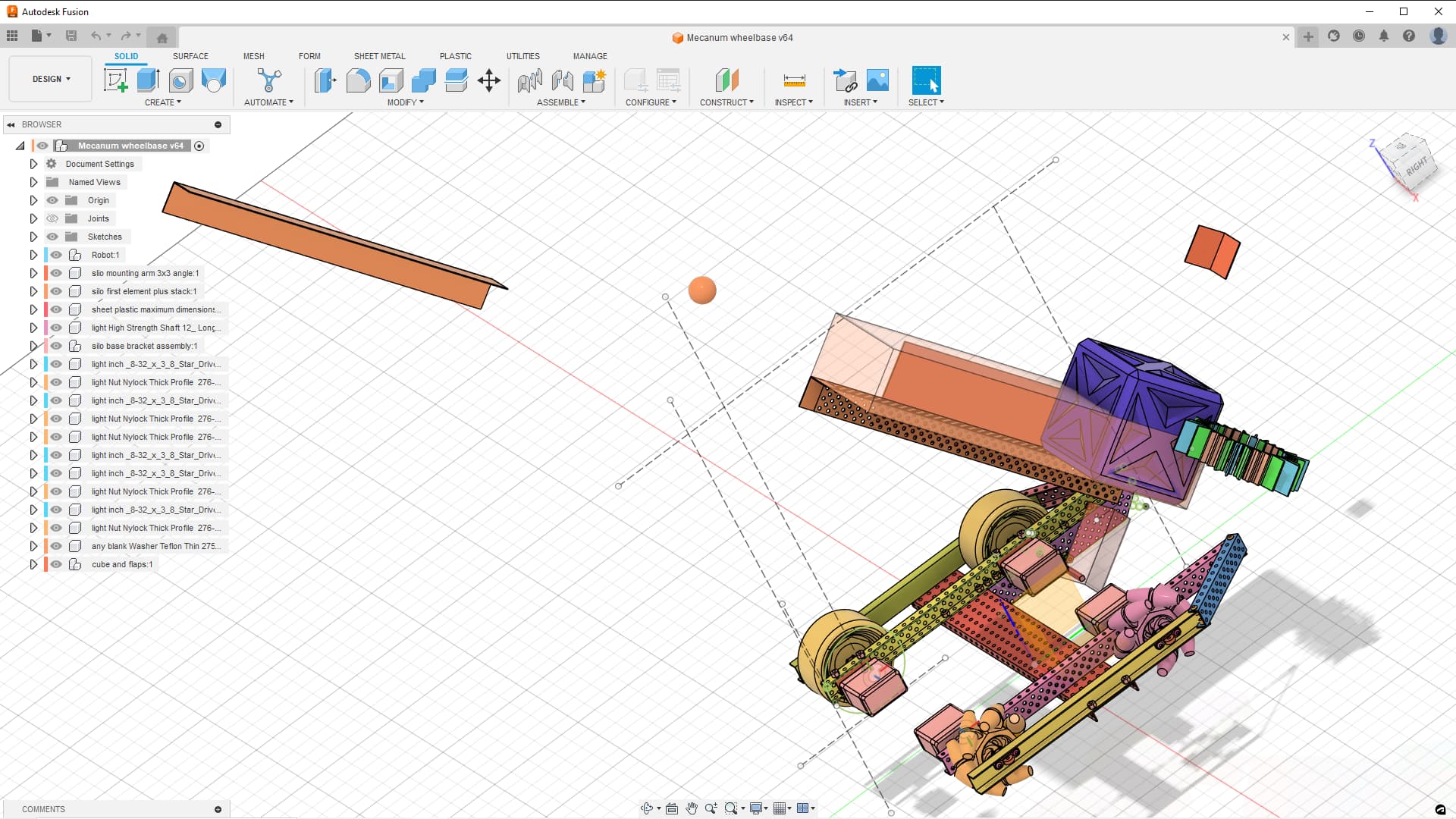

You don’t need to disassemble and sort the parts of a CAD model to move on, and you don’t have to obey the laws of physics during the build. Once you’re familiar with the physical components so you have some feel for how they go together, and with the CAD package, CAD is a lot freer and quicker than spanner land.
Here’s an ancient model showing reasoning about centre of gravity and searching for good pivot points and space:
