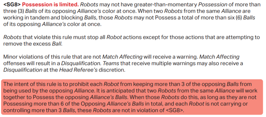

One thing that I don’t see prevailing is a 3 ball hoarding mechanism. Why hoard 3 balls when that prevents you from picking up any others? You would honestly not want to hoard more than 1, and then that isn’t really hoarding so much.
no they would be seprate meckinisims
also if u have more that 3 of your own ball ur doing skills weirdly or your doing something wrong
This is not an actual ruling.
https://www.robotevents.com/VRC/2020-2021/QA/608
As long as the first thing you do after you momentarily possess more than 3 balls is eject the extra(s), you will be fine.
I know that. Meaning you putting yourself into the line of fire of the rules to some degree. To me, putting myself at a disadvantage isn’t going to help me win any more even if it has a slight tradeoff benefit. At that point, you still have 10 opponent balls minimum in the field, they can still get all of the row bonuses, and you have successfully impaired the robot’s level of function.
