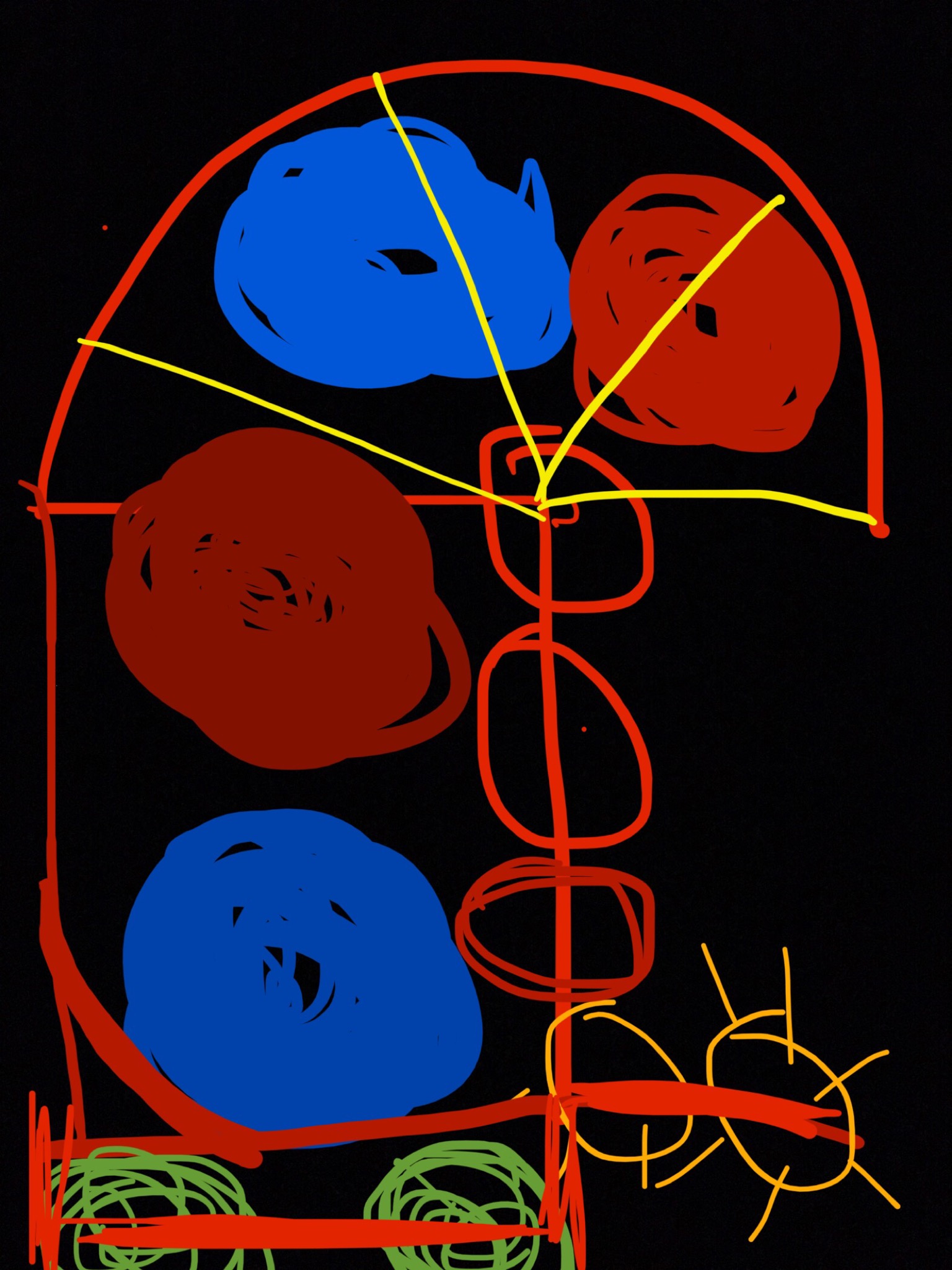

I believe that something like this will be the end season meta.
And this can truly be called a “snail bot”.
This design would eliminate any need for a flywheel, which would make things a lot easier. Also 1 motor indexer
I disagree with this. There is no physical way to make the robot hood arc 180 degrees from the highest point on the robot and still have a working scoring mechanism. The towers are slightly taller than the robot height limit. to achieve this, one would have to make something along the lines of a… hmmm… THAT could be meta. Nevermind. Let me test this design first… I’ll let you guys know if what I’m thinking of works (along with the design oc).
Well if you imagine that each line as a stage its possible to reach the third line without some fancy mechanism
It’s not that though. The limited starting dimensions of the robot (18" x 18" x 18") are not taller than the goals (approximately 8.4"). This being said, if you hinge those stages at the point at which you do (assumingly the highest point on your robot) the bottom of your hood will be slightly shorter than the goal. Not to mention, you are going to lose a little more height when you hinge the hood stages do to the holes no being RIGHT at the top of the c-channels.
Plus with my current design The flywheel is at 17”
Which means that the ball always had to clear a 1 inch gap to be scored
Precisely. After your robot starts to drive, you would have to have a mechanism that lifts the ENTIRE mechanism about 2" (ideally). That way, there is no QUESTION about the ability of the robot to score.
Or you could have guard rails to prevent the ball From missing
Imagine the yellow lines but as rails
Ummm… they ould have to be anyways to support all of the different stages…
I meant no extended hood just rails Till the second line
