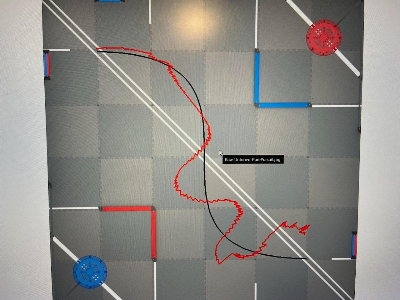

Which was supposedly a “catch all” odometry solution to know where the robot is at all times. However, it has immense limitations in its tracking quality.
For example, in this post here: Is GPS a great tool for autonomous? - #5 by jpearman
Jpearman states that it refreshes 25 times per second. If the robot were turning at 100 times per second (for example with a 600 RPM on 3.25" wheels roughly), the robot would turn 24 degrees between each frame which is quite significant especially if you want to have a reactive PID.
You can see the GPS Sensor tracking vs real world movement in the comparision:
Source: Is GPS a great tool for autonomous? - #11 by Bubski

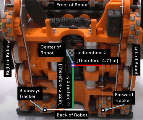

For wheel-based odometry, I believe that 2 wheel + Inertial sensor is the best to establish odometry coordinates. It has the least amount of space for the highest possible accuracy. You can add more wheels for redundancy but it’s not necessary.
  • It WAS almost entirely necessary to have 3 wheel odometry with V4/Cortex because the gyroscope VEX sold was not that good of quality, especially with drift. But the V5 inertial sensor is leaps better.
Here’s an example of WISCO’s odometry, a picture taken from a First Updates Now (FUN) interview:
