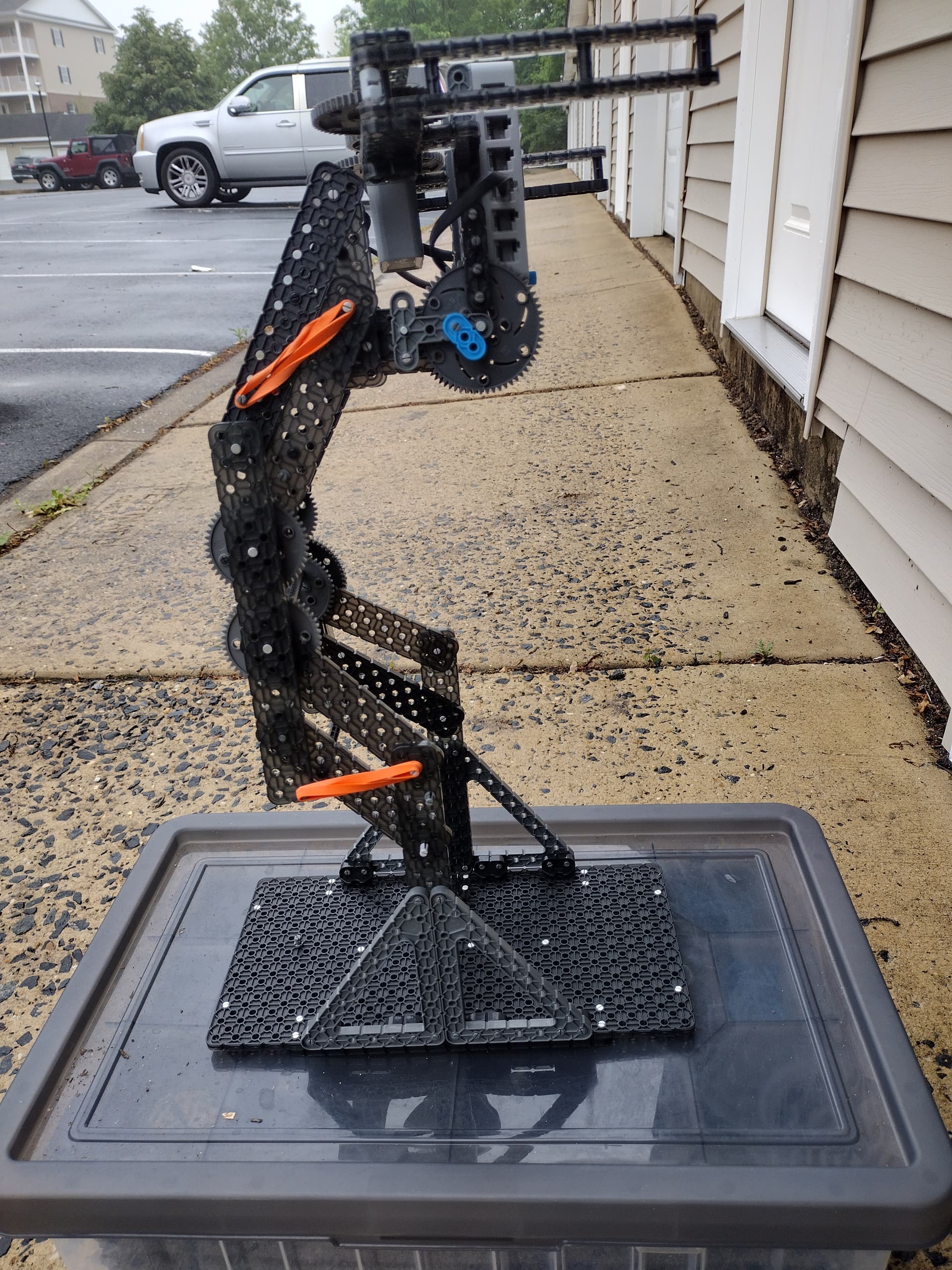

Double reverse 4 bar linkage. You really want the height, the forklift on the linear slides will only get you so far.
again, a dr4b would help

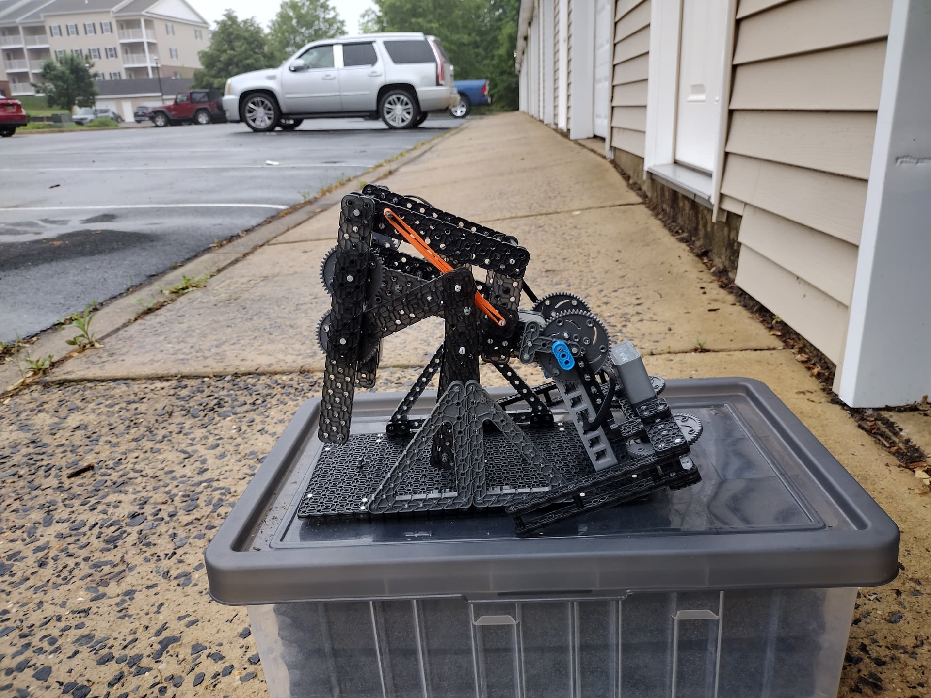

So you will note, no drive base. This was on a 6 wheel drive base, center friction, outer omni.
You will also note that the brain is on top. This was a demo, “telepresence” robot, where you would see a mini face on the screen. It was also a demo on how much it would lift, it manages the brain and the battery pretty well.
Of course this makes it a little top heavy, hence the bigger base that it sits on.
You’ll see that it’s flat plates, it’s part of my flat to wheels system. I build bases that will snap onto the flat plates, then build linkages / operations that fit on the flat plates. This lets me move bases around, operations around. I have an ever growing collection of sample robots, this gives me the ability to quickly put things together for a demo.
The take away is if this linkage can go this high AND with a brain on top, a little set of changes should make it easy to grab game elements and lift them up to the top of anything.
Sorry for the lack of awesome backgrounds. I pulled it out of the famed robot garage and did two quick pictures.

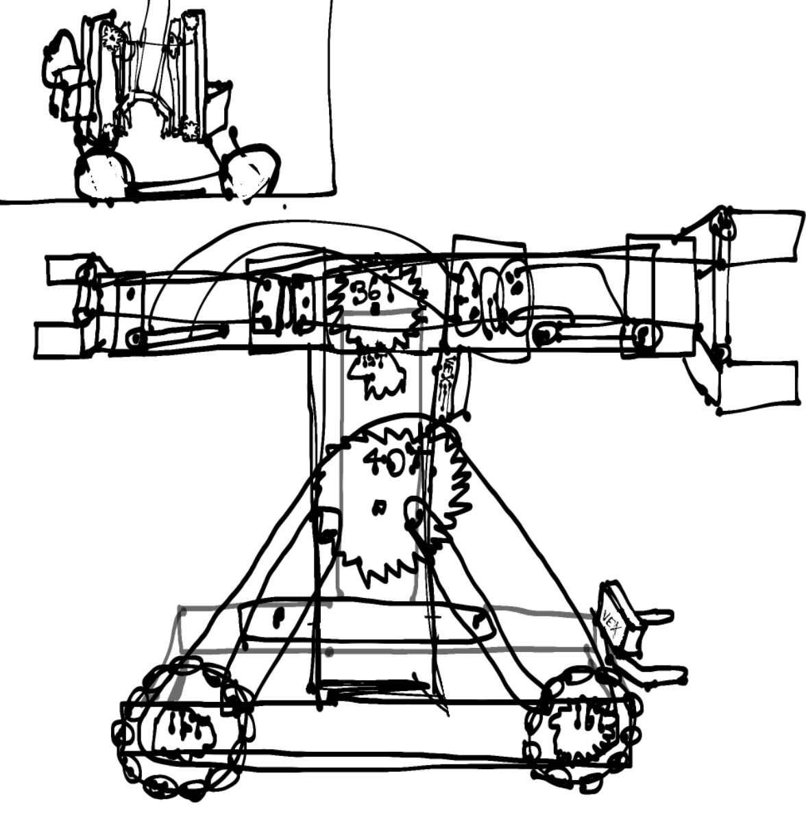

Some kinda robot with a Ferris wheel type thing that can expand vertically via the lift mechanism used in full volume’s landslide robot. It has claws on either end of the wheel that are powered by pneumatics. It’ll prob use a diffy pto splitting 4 motors among the lift and Ferris wheel. It also has a kinda mech on the back that grabs a stack with a claw.
