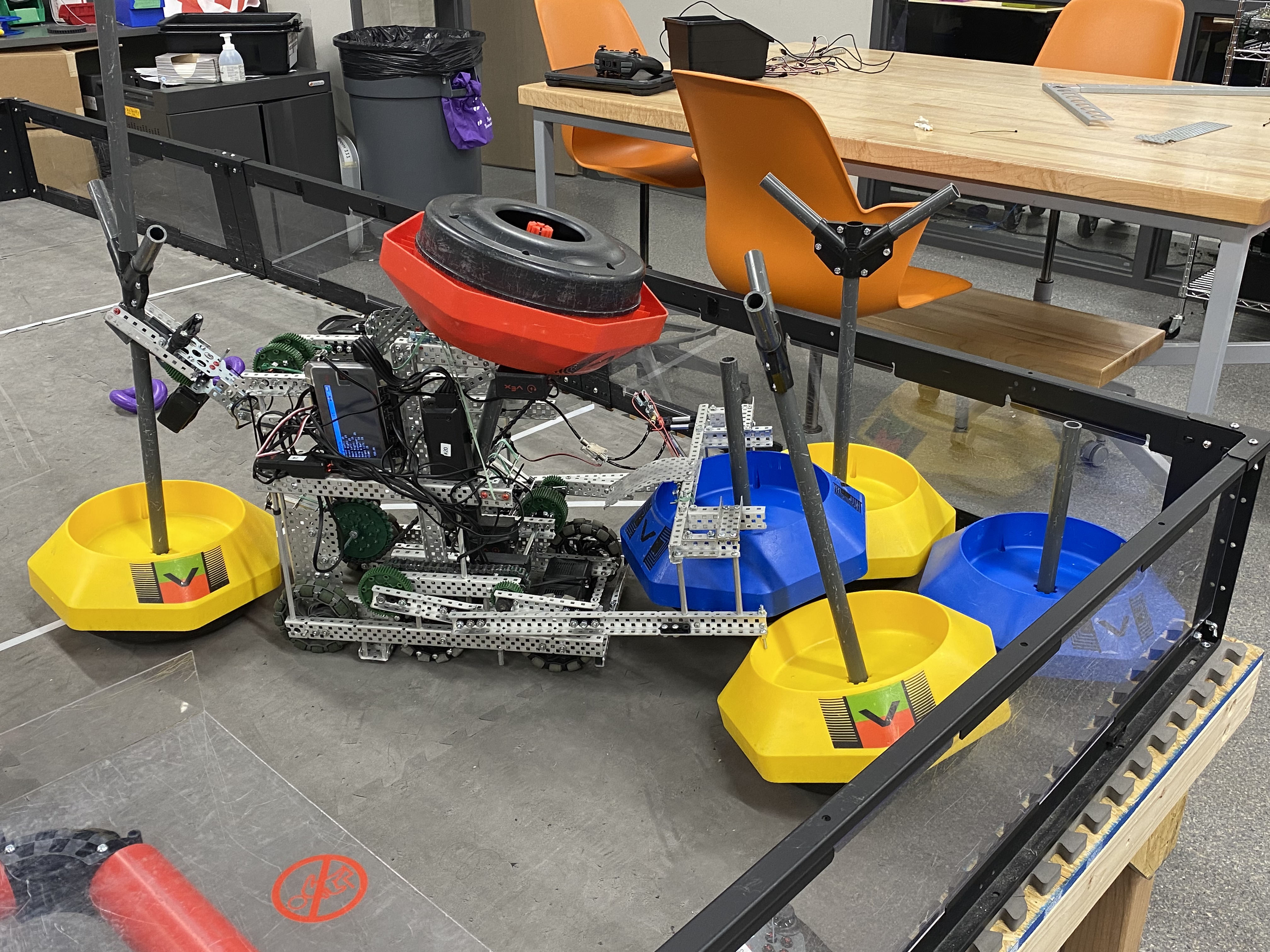

Not an SG7 violation:
Kind of broken.
Why do you think this is not a violation? I think it is…
First, the GDC has always maintained that Hoarding should be “rare”.
Second, it is difficult to tell from a still photo, but I would be surprised if the 2 yellow goals towards the corner are directly “Possessed” (e.g. would they move when the robot moves?). It seems likely that 3 goals in the corner are not “directly possessed” and therefore being hoarded.
Third, without an opposing robot moving towards these goals, there can be no Hoarding call anyway, which is reasonable.
Only one goal is being hoarded, The other 5 are possessed.
The yellow goals are in fact possesses. When the robot drives away from the corner, the yellow goals go with it.
Ah, okay! Possession of the two neutral mogos in the corner wasn’t clear. If they are indeed possessed, you’re correct and this isn’t a hoarding violation. Wow!
Assuming that true, when the opposing alliance makes an attempt for these goals, as a ref, I’d probably need you to demonstrate that Possession is being maintained throughout the encounter. Though given that you clearly Possess both Red and Blue goals, you’d receive the benefit-of-the-doubt for being “offensive”. Given that there is no time-limit on Hoarding, one could argue that this robot would need to demonstrate continuous Possession of the 5 goals its touching throughout the encounter with the opposing alliance’s attempt at those goals, because it would then clearly be “actively stifling gameplay”
