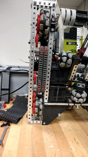

44w 450rpm on 3.25. Only 4 wheels. Mix of sprockets and gears ( back wheels will spin no matter if chains break) we ran this all through great planes and had 0 issues with chain breaking.

yk I used to be against chain drives in v5. but that is one nice chain drive. great job!
Do you think the chain would break at all during the season? And if it does, how much would you lose? Just wondering.

Some time during the season it will probably break once or twice, that is why we double chain it. Also the back wheels are connected by gears to the motors, so we will never loose out on movement.
