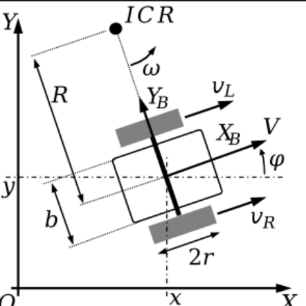

heard about differentials, have no idea what they are. any answers?

It’s worth pointing out that differential and differential drive (which is your diagram) are different. Differential drive is what you would think of as a “normal” drivetrain, while a differential is what Theresa explained above.
