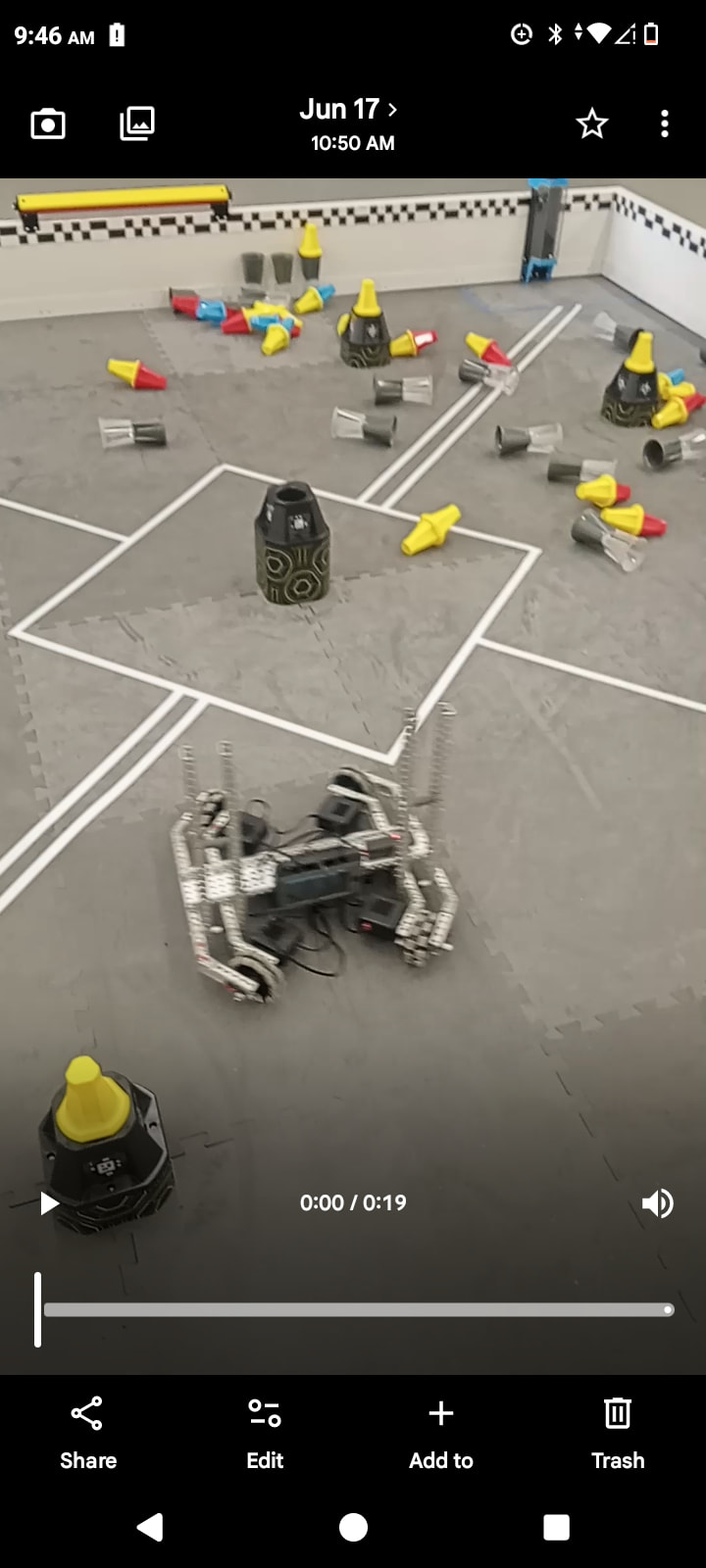

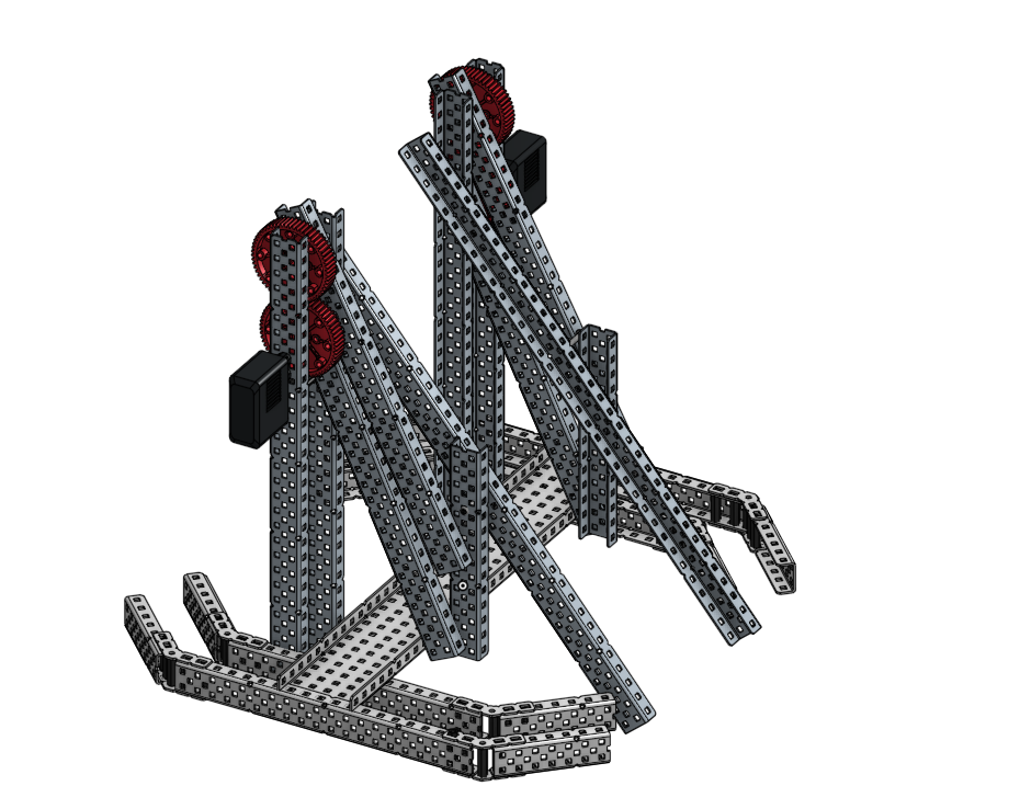

Hey here is a x drive frame I made (ignore top stuff it’s for 2b) it’s just a frame.
Here is also a image of it built
We were leaning towards and H drive because of the cons you listed. We were thinking of just adding a horizontal wheels so that we can go side to side because i’ve seen a lot of teams with and h drive get stuck in between the goals and the wall. What would the cons of having the horizontal wheels be. I already know we would be capped at a 44w drive as we need a 5.5w on the horizontal wheel.

I feel the ability to strafe is necessary because from the early season tournaments, a lot of team are getting stuck in between the wall and the goal. That’s the only problem I see with the h drive compared to x.
Strafing is kinda needed, for example at the starting of the match, there are premade stacks directly to the side of the robot, and strafing gets to the stack so much faster than a tank. This is seen in several placements on the field.

One of the huge advantages of x drives this year is that it you leave the outer rail on the back or front, you already have an aligner for the goals. Another advanced is during auto and driver you can strafe around goals and stacks. Not insulting to the h drive but with 35-50 inches of elevation, I don’t know how fast or strong the h Omni wheel will be.
I’m fairly certain the number is actually 70% for x-drive, plus you get equal power in all directions
Yes, our team has noticed that x drives (and we got lucky) have a aligner already built in. Our actually fits the goal perfectly :smiling_face:
