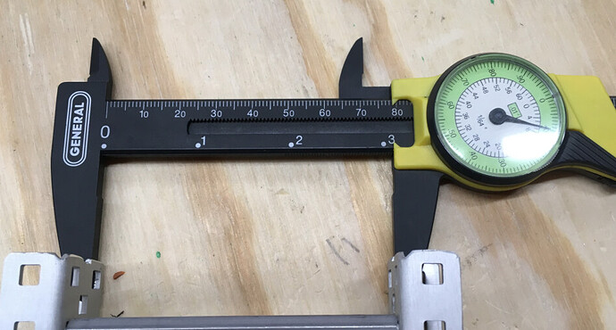

  4. MEASURE the spacing on all arms/etc to make sure they are parallel. Measure spacing on your chassis /etc also.

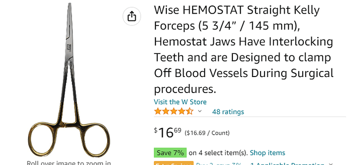

    c) medical hemostats (even better than needlenose pliers, can be bought in fishing section of wal-mart or gotten from amazon).
    d) cheap calipers can be a real time saver for checking dimension. this is also how we found why our out-of-spec axles were not fitting into anything.
A pair of hemostats will speed up assembly more than any single item you will ever buy. They can hold nut in tight corners. They can ‘fish’ screws through tight spaces into holes with a speed and precision you won’t believe.
