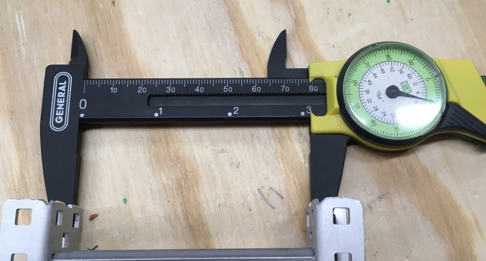

    d) cheap calipers can be a real time saver for checking dimension. this is also how we found why our out-of-spec axles were not fitting into anything.
