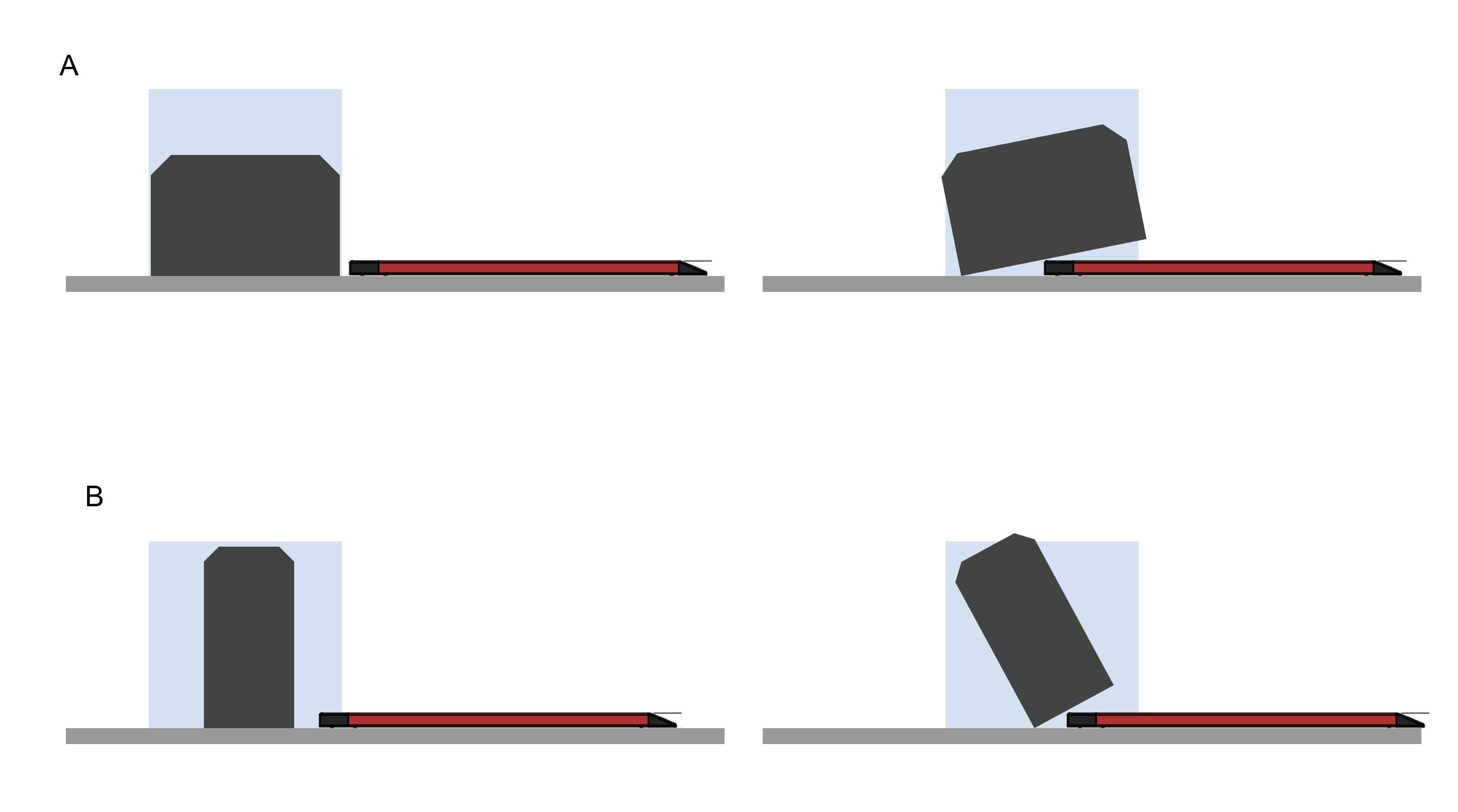

Expansion while driving over the barrier
Both robots A and B pass inspection and fit within the size limit. However, robot A is very close to being 18 inches long, and robot B is being very close to being 18 inches tall. As these robot drive over the barrier, they change there angle and orientation. As robot A drives over, the bottom front of the robot and top back of the robot are now more than 18 inches apart in the x (horizontal) axis. The same thing happens to robot B in the y (vertical) axis.
To start, this q and a seem to give the impression that the legal size does not rotate with the robot. Is this correct?

Would robot A be expanding beyond the 18" x 18" area and violating rule SG4 even though they are not physically expanding?

Would robot B be expanding beyond the 18" high limit and violating rule SG5 even though they are not physically expanding?
Should inspectors check and see if teams are at risk of violating either of these rules during inspection? If one or both of these robots is committing a rule violation, how should the referee know if such a violation occurred Especially considering it would be a small expansion beyond allowed tolerances, and it would not last long. And finally, would this be considered a major violation? The argument could be made that it is a teams own responsibility to know the size of their robot, and the team would be making a conscious decision to drive over the barrier thus intentionally violating the rule intentionally. Also, this violation would strategically impact gameplay as it would likely save the team time rather than driving around the barrier.
Also, would the answer be changed at all if it was a robot driving over a disc instead of the low goal? And would the ruling change if the robot got stuck outside the legal size limit while driving over the barrier/disc.
Below is an image showing the scenarios. The barriers are in red, the tiles in light gray, the robots in dark gray, and the legal size area in light blue.

I will be posting this later in the q and a, just thought I would show it to the forum as you can’t view unanswered questions. Personally, I feel these would both be violations, but it would be very hard to enforce these rules.

First, remember that these are not official answers, but the quick answer is that referees do not look at these incidental and unintentional bits of expansion that occur when a robot bounces over a barrier or comes to a quick stop and rocks up onto its front wheels, etc, and momentarily but unintentionally breaks the expansion limit.
I know that. However, driving over the barrier is not unintentional or incidental. That’s why I think it might be illegal.

I think in the way the rules are written and the situation you described that the robot does violate SG4 and/or SG5. Another example of this could be driving over a disc which lifts you up slightly, and to that point what happens if you get stuck on a disc?
I don’t think that these situations should be legal and that some clarifcation is necessary.
I’m going to assume that it would all illegal or all legal as either way all vertical expansion must be beneath 18 inches unless you do the weir cylinder thing.
I’ll edit the original post, but I think that would be less likely to be ruled illegal.
The sizing box moves with the robot though. If the robot didn’t expand I don’t see why it would be out of size.

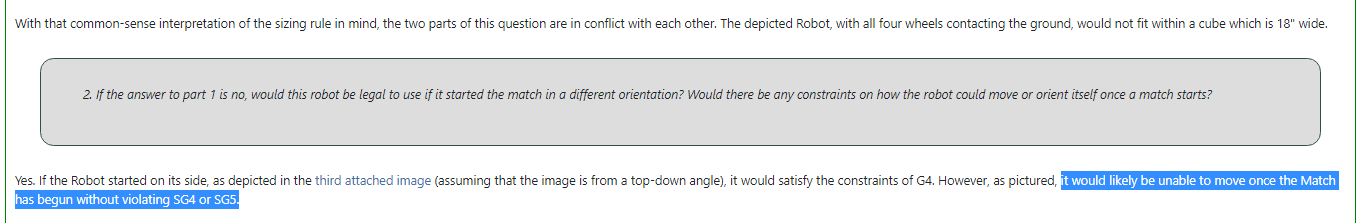

Except it very clearly doesn’t do this. The GDC has explicitly stated that the sizing box is parallel to the ground.
https://www.robotevents.com/VRC/2022-2023/QA/1119
Good point, however this case seems a bit different. The robot does start within 18x18x18 parallel to the field at the start of the match.
The GDC has an answer for that too!
