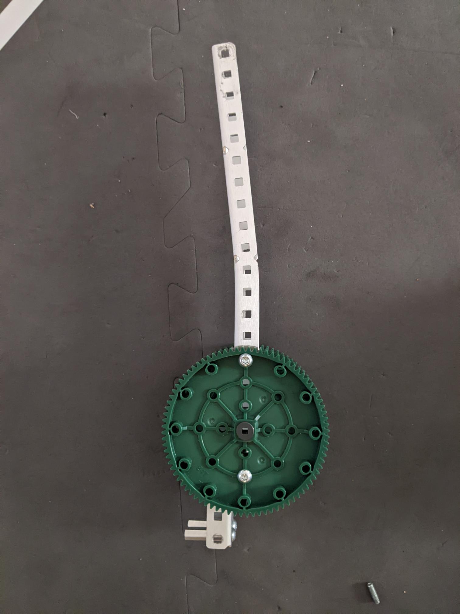

Oh, and also, if anyone wants to see the remains of an aluminum catapult arm, here it is.
ouch
I agree with everything you say but not the steel arm part… You want the arm to be as light as possible, so you can decrease the stress on the motor, so using steel for it is disadvantageous. If done right an aluminum arm should be all it takes for a working catapult. You can build your tower and Ext with steel, but I would not recommend using Steel for the arm itself.

Looks like you used the weaker side of the c channel. An aluminum arm works great- you want to keep it as light as possible.

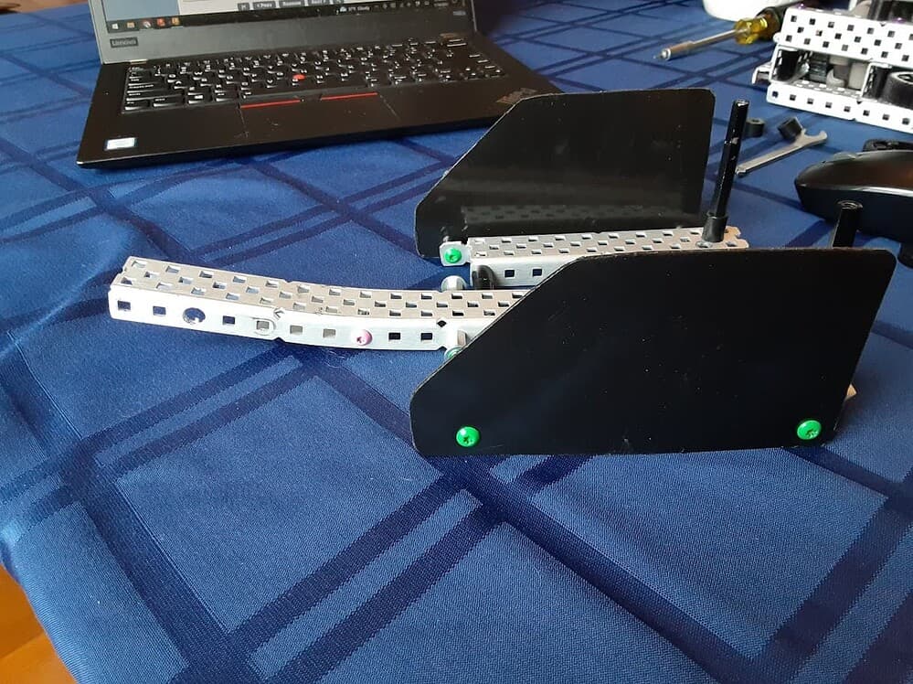

Lol I have one too:
(What I will say is that out cata is different from others, we have a short catapult arm, which means that we need a lot more rubber bands to make up for it, which meant more stress on the c-channel. Don’t recommend.)
We also use a short catapult arm, 20 holes long. Because of this, as you said, I had to compensate with more rubber bands. Right now I have 12 rubber bands, and even with this amount, 3-disk shots only barely make it in. Definitely recommend a longer cata arm, but if you have a short robot like me, it isn’t really possible.
Why did you not just box the c channel and add another one under it?
I actually had it boxed with a c-channel coupler under the stress point, and it still did that :grimacing: . I don’t think I can add another c-channel underneath, as that will run into shafts and motors and other stuff.
I know it’s a pretty bad solution, but I just switched out the main one for steel, and no issues so far. I had to retune a little, but it worked out alright. I had limited time before a tournament.
instead of orienting your c channel so that the wide face hits your hardstop, make it so that one of the flanges hits your hardstop, and simply box the one point of impact. It’s as easy as that. We’ve never bent or snapped a catapult arm ever.
Well a coupler wouldn’t work simply because of it’s length you would need to box the whole length or it’ll bend
