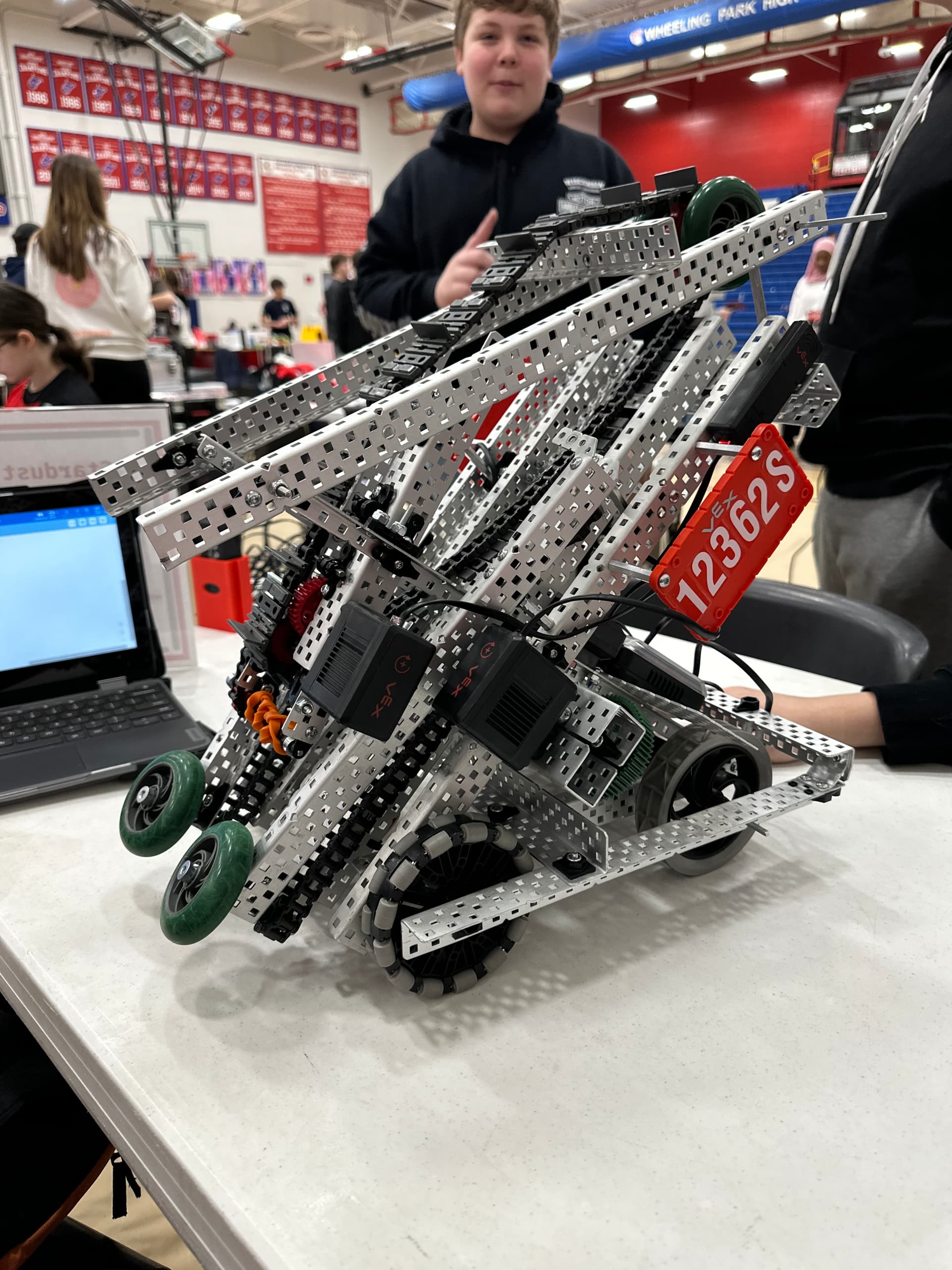

What should I do for my robot? I have the the herobot And I want to either make modifications or make a new robot.
I’m going to tell you the same thing I told your sister team:
You can’t really ask other people what you should work on. Do research on different mechanisms through Forum, YouTube, etc. Compare designs, figure out what you can implement in come way or take inspiration from someone’s system.
My team and I actually saw you at Palace on the Hill today, but I don’t really remember your robot’s performance. My suggestion is for you and your team to make a list of what worked well, what didn’t work, and what your next steps will be. Does the drivetrain work well (I can’t quite see the drive motors, but please make it at least 4 motors instead of the standard 2 for heroes for more power and balance)? Does your intake work well? Should you rebuild/rework something or are you ready to start making more? Plus, all this brainstorming can be put in your engineering notebook.
I feel like you can usually tell which robots are modified hero bots because of the shape, so try looking for specifically modified hero bots and see if you get any ideas modifications that are feasible for you. There are plenty of resources out there for inspiration. I wish you and all of your sister teams luck!
Welcome to the forum,
I would recomend adding 2 motors to the drivetrain for extra power and less overheating.
After that i would recomend adding a way to collect/store multiple blocks at a time.
Honestly, it depends on what materials you have access to to improve it.
If you are stuck with 4 motors total and no pneumatics, I would recommend just making modifciations to the herobot you already have to allow for more potential storage, better game material control, etc.
If you have access to pneumatics (and maybe more motors!) this starts to become a little bit of a gray area. If you have the other materials for it (more c-channels, chain, rubber bands, other essential competition stuff) I would recommend a full redesign to a Rugian Style bot (otherwise known as a slope bot, look it up on YouTube if you need to).
If you don’t have any extra materials in this sense, again, just make modifcations to the herobot that you already have to make it better.
I could honestly go on and on. Could you tell us what extra materials you have so we can give you a more clear answer?
