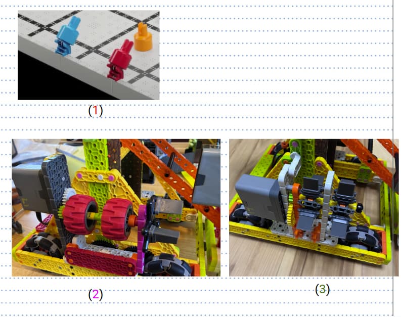

Every robot can knock the starting pins off the holders for 2 points but not sure how many have device dedicated to it. My son did some work on his bot’s lift arm and reduced the motor need from 2 to 1 motor. Not sure what to do with the extra motor initially, he quickly decided he wanted a dedicated ā€œpin knockerā€. Pic from his team’s notebook page. ā€œPin knocker 2.0ā€, (3) in picture, does seem to be an improvement over the original (which tended to knock the pin off by simply destroying the entire pin holding mechanism lol).

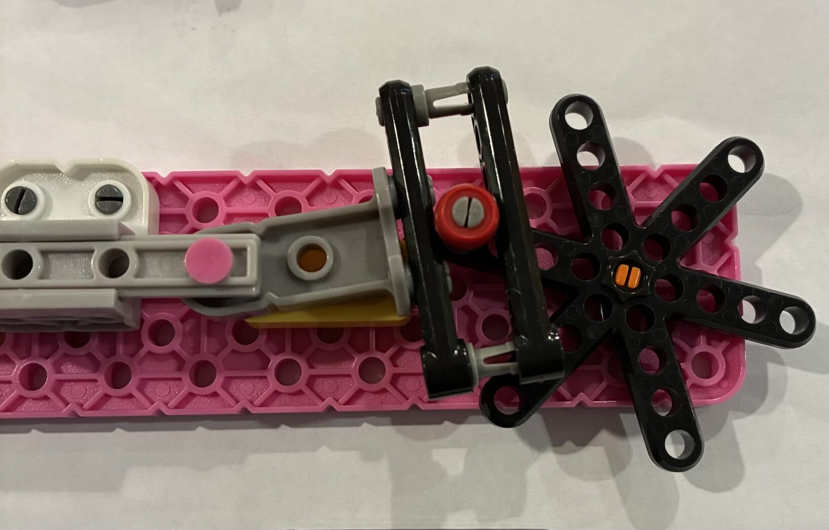

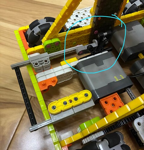

Follow up courtesy of my son. His team decided that PINKNOCKER :copyright: (my son started using the copyright sympbol in the notebook lol) wasn’t very useful, but that they needed a device to help gently push pin stacks for the small square goal, or center yellow goal where the stack isn’t totally within the goal. Doing this with their robot during the heat of a match often results in knocked-down stacks lol. So he used a scotch yoke design to make a reciprocating device and coded it to run at a slower speed. The Scotch yoke is much more complicated than a simple crank and slider. He saw both watching this video https://www.youtube.com/watch?v=dngl2F_IRyI. His yoke hits the ground, jams, then ā€œself-disassemblesā€ when spun in one direction so he coded it to just spin in the other direction. Since it’s reciprocating it really only needs to run in one direction anyhow. When asked why the more complicated mechanism when a simpler one will suffice, he noted how much he liked the Scotch yoke idea, which is as good a reason as any in this case, I guess. He calls this PINPUSHER :copyright:. It works as intended but will need to be battle-tested on an actual playing field with the whole team driving.
