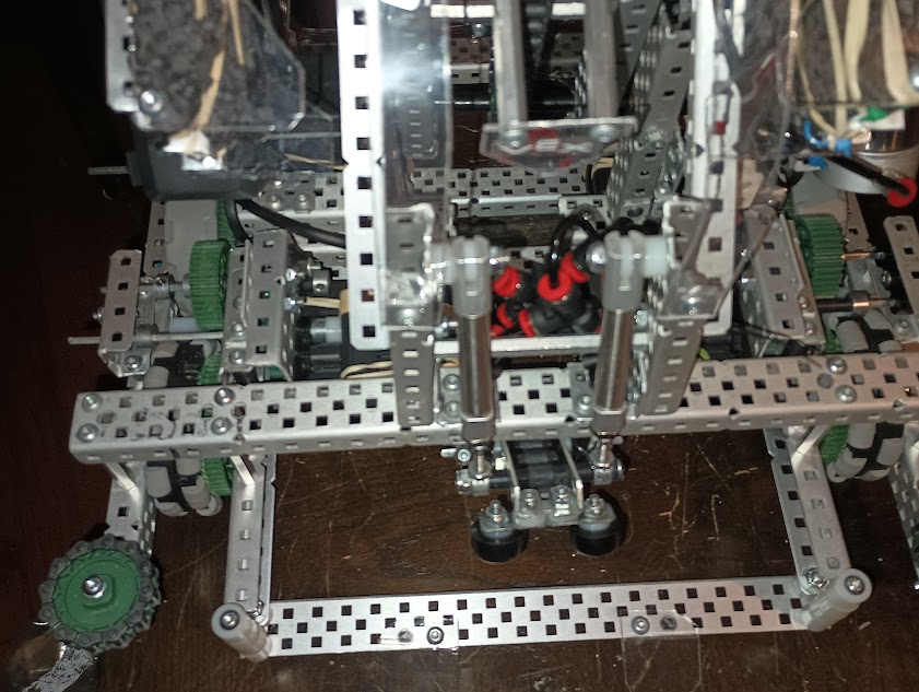

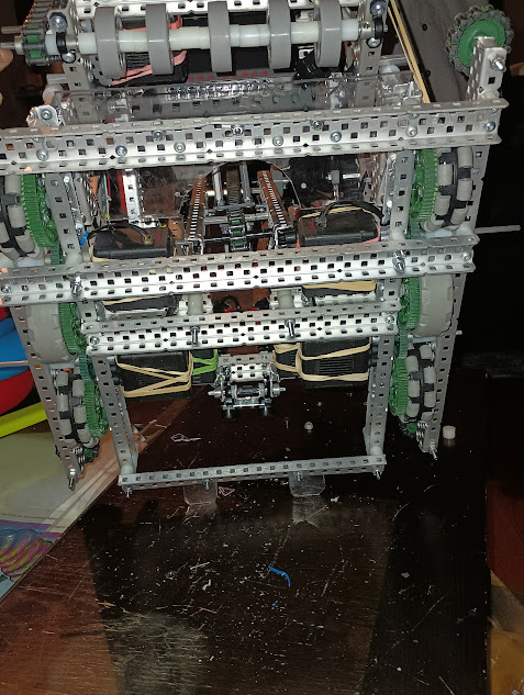

We used one brace to initally hold our halves together, one more to mount the goal clamp, one more for the goal to run up onto, and our intake also holds the front together
Might be a little bit overkill, but it works

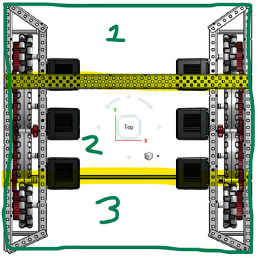

Two at the least. Here’s a rough CAD of my drivetrain, for example.
Due to this year’s challenge requiring mechanisms on both sides of your robot (mobile goal clamp and ring intake), you can see that I put the braces so it roughly divide the robot into thirds. One is a c-channel on top of the robot, and one is an HS axle on the bottom of the robot (though I recommend using a c-channel if possible).

Probably 3 will be plenty, with one for each third of the robot, but adding more should be fine if you need the area to build off.

(Thanks for the picture, a big help!!!)
