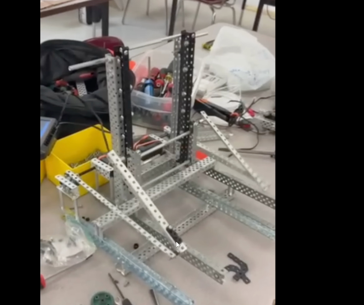

btw, for anyone wondering what a 4/6 bar is and how to build it…
this explanation and demo by Kepler Electronics is really useful. This video specifically focuses on a dr4b.

I agree that a 6 bar is likely better in an ideal world but I have done the math as well as mading a prototype cad design. I have gotten the expansion up to 48 inches without even stressing the 18" collapsing limit. with a long starting point and a deep collapse point a 4 bar works well.
