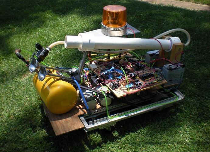

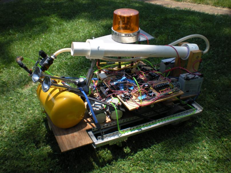

i would try to use MPLAB too. it really is a great experience but does require some learning. but in the long run, it will help you a greaty deal, especially for other robots. like this bot i built, programed it in MPLAB, and EasyC Pro, but with EasyC Pro, i still used some of the C programming features.
hope this might encourage you to try C programming in MPLAB, but instead i used the IFI Robotics hardware, though all you need to do something like this with vex is setup MPLAB for vex.
