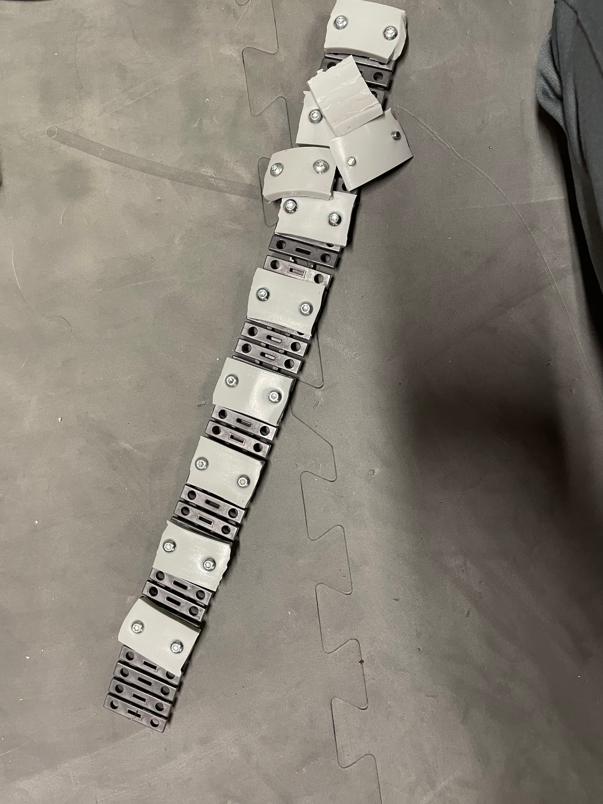

You can solve this with an intake like this
Oh yeah I have the CAD files of this and a bunch of other robots I frgt about them.
