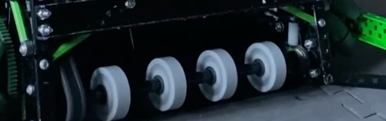

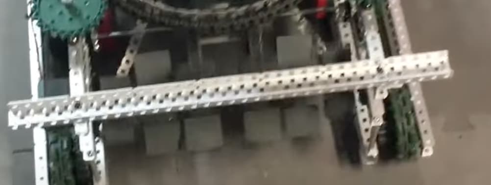

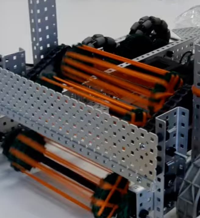

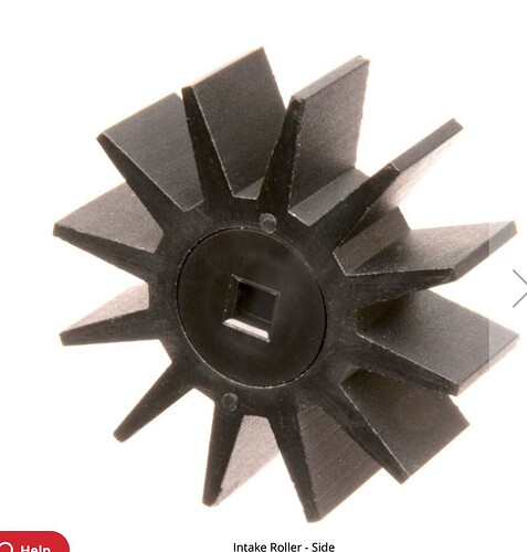

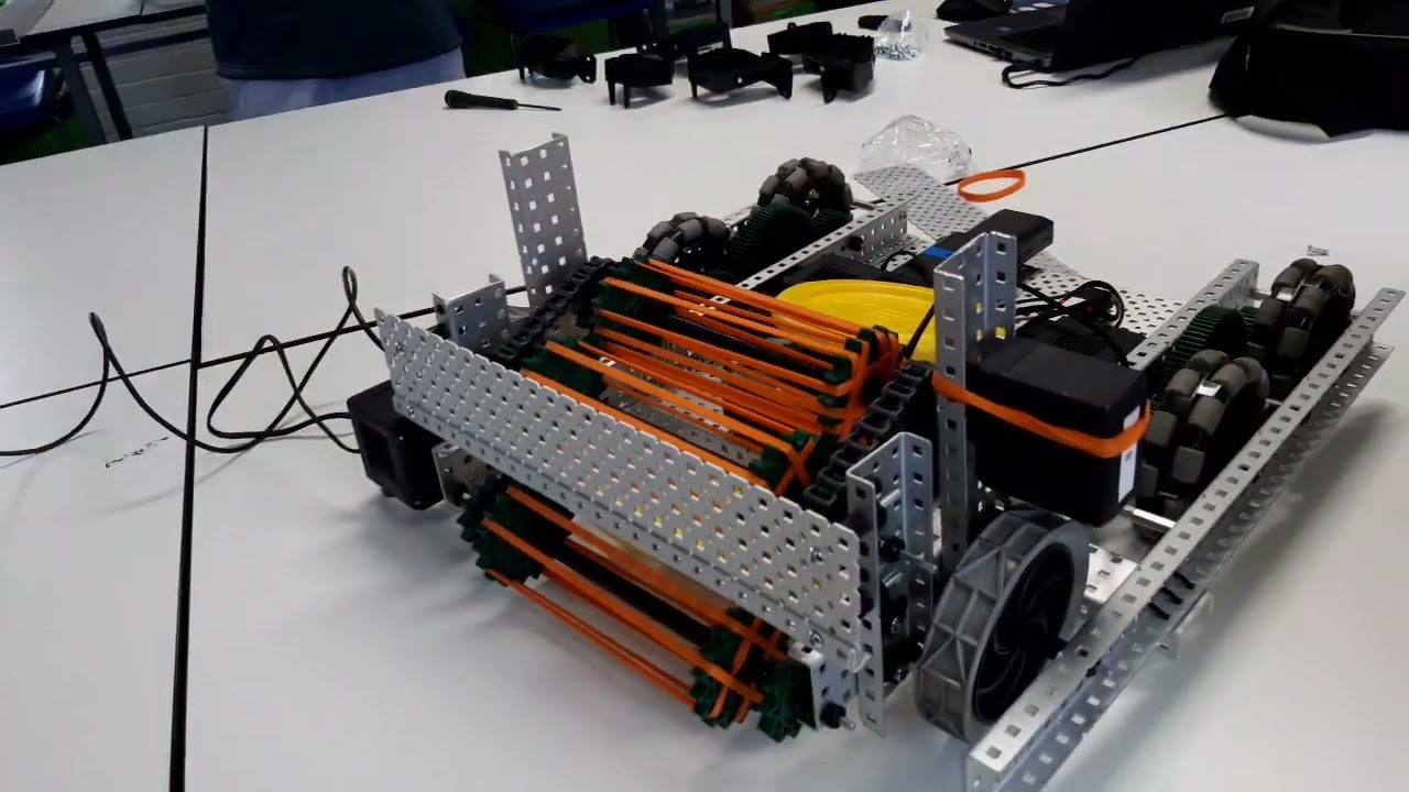

My team and I are trying to figure out which intake is best for spin up. We found 4 and are not sure which is better. Each team mate has their own opinions on which one is better. So decided to ask vex forums which one is better.
1.
2.
3.
4.
To any of them better here are the links:

imo the flex wheel one is the best. but the rubber band rollers or the paddles can work they are all viable

While I have minimal context for the size and means of your robotics club, it seems like it would make sense to aquire the parts to test these concepts. Tread with flaps on it can frequently be used reasonably effectively in many games. The same goes for the sprockets used in rubber band rollers. Both of those use somewhat basic parts that would be useful down the road if you can get them now.
Also keep in mind that you don’t need to build an entire intake to test these. For preliminary testing, we built an example intake roller using several different techniques. (Rubber band rollers, flex wheels, a few crazy ideas we had, etc.) To test each, we used a drill to spin them and moved them over a disc on the field and observed the results. There were stark differences in how each technique interacted with the discs. If you don’t have a drill, you could build a temporary gearbox with a vex motor.

I would personally say the flex wheel one because it’s easy to build and can skim and pick up stacks of 3 pancakes. but it does depend on you design, like the sprocket one is also good one if you have a shooter like the sig bots.

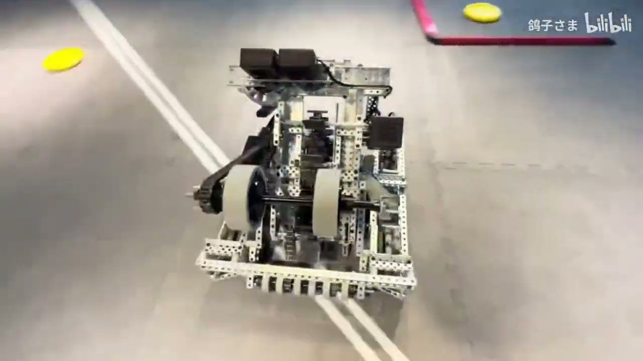

I would say the flex wheel one as it is the only one that from the intakes you listed that has been used on an actually competition viable robot.
The flex wheels work well for us.
China has also found that flex wheels work exceptionally well:

What I meant by my original reply is that the flex wheel one is on an actually working robot and thus is proven to work. If you had the resources I would go with the flex wheel one but if you don’t the rubber band one will probably works fine.
