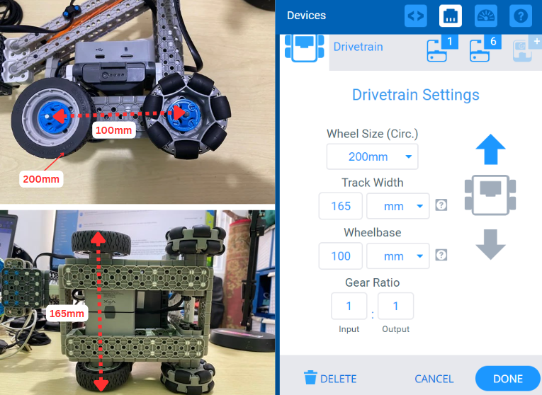

Hi @imconfused, thank you for the detailed steps. I have adjusted the Drivetrain settings with the appropriate values, but the issue still persists.
Regarding the gear ratio, since I connected the motor directly to the wheels without any intermediate gears, is a 1:1 ratio the correct value?

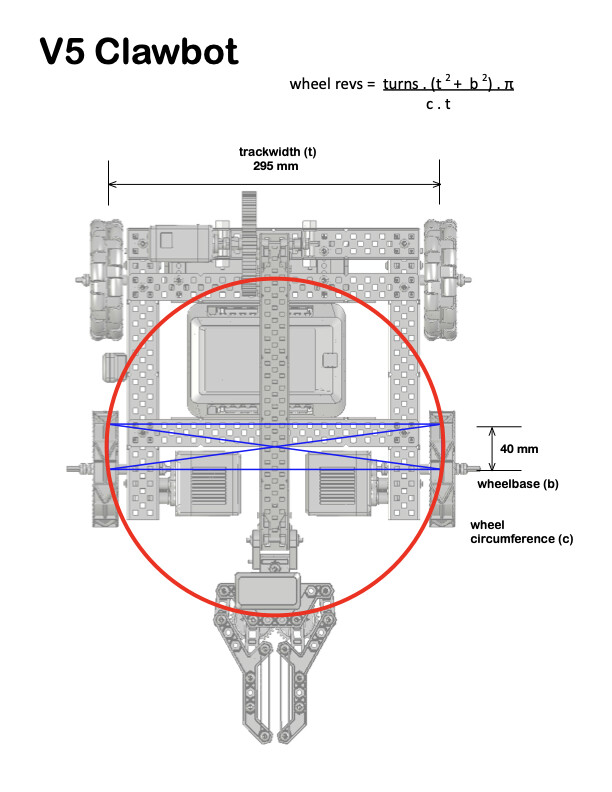

Wheelbase really depends on which wheels are being driven, just two or all four.
for example, this is V5 clawbot that just drives the front two wheels, wheelbase is measured using the center of rotation in this case.
What is the 40mm measurement going to on your diagram?
radius of the wheel which is used to calculate circumfrence.
I didn’t explain the diagram, should have done that.
and this only applies when not using the inertial sensor for turns.

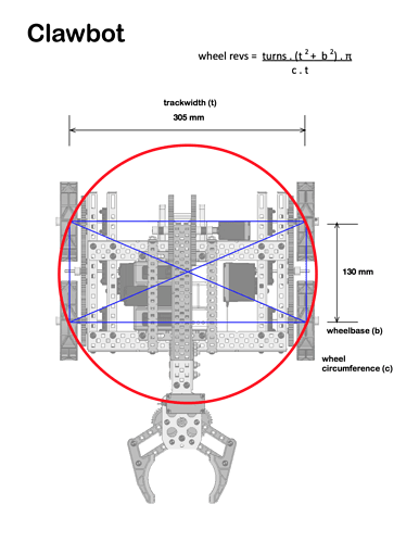

The calculation to determine how to turn the robot a given number of degrees uses three parameters (well, and gearing but I’m ignoring that here)
wheel circumference (c)
trackwidth, the distance between the wheels, (t)
wheelbase (b)
The wheelbase is where the difficulty comes in, it may be the distance between the wheel axles, but for a robot that, for example, only drives the front wheels it will be much less.
Usually it will be twice the distance from the robot’s center of rotation to the driven axle, that’s what the blue box in the diagram of the V5 clawbot I posted is trying to illustrate, wheelbase in this case would be set to 40mm.

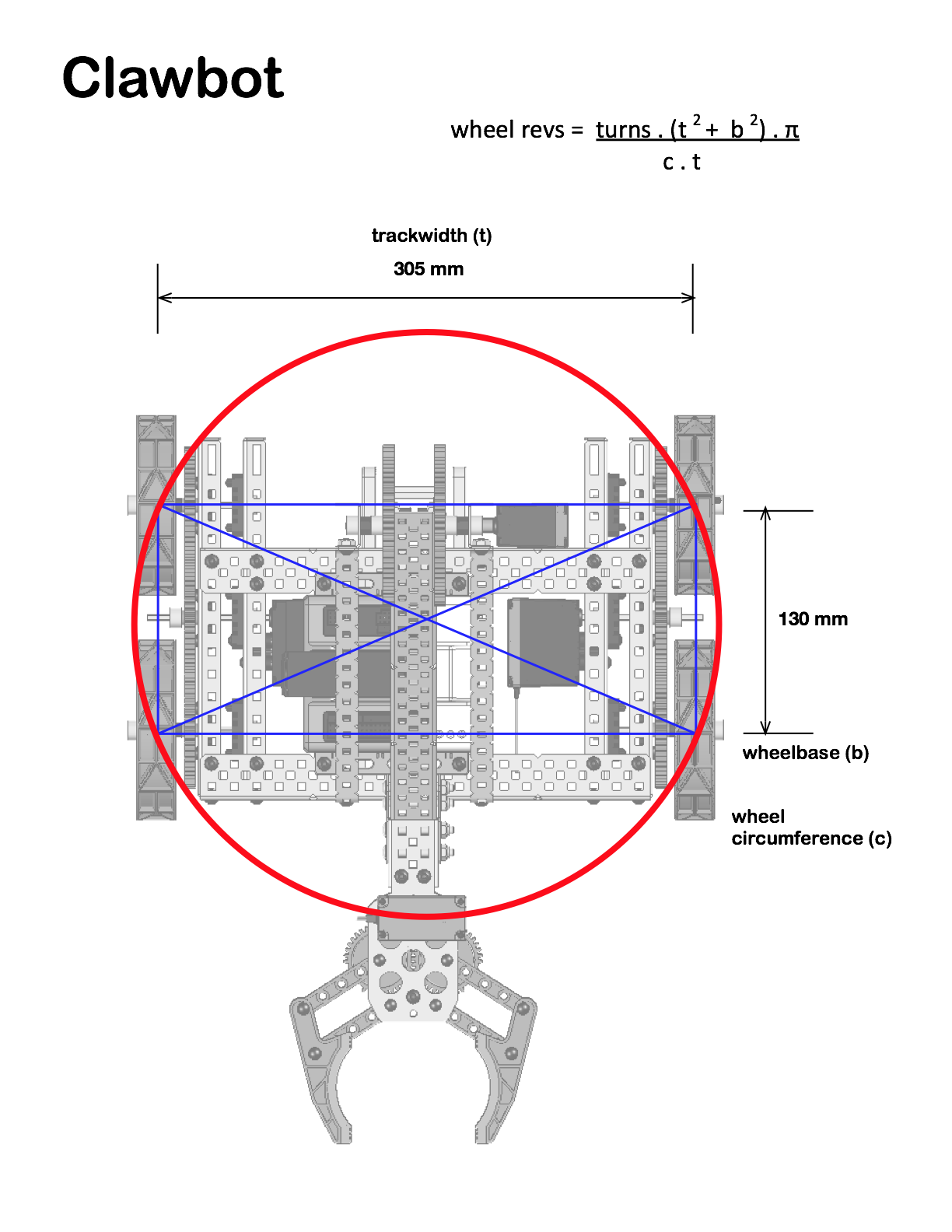

Here is a drawing of the old cortex era clawbot, it was driving all four wheels and the center of rotation was more or less between the axles.
Hi @imconfused and @jpearman thank you for the detailed solution you shared.
This morning, I tried resetting the connected device and recalculating the values for track width and wheelbase, then tested it using a new project file — and finally, the turns were perfectly 90 degrees.
