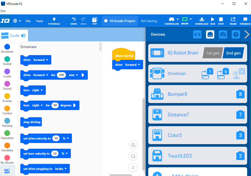

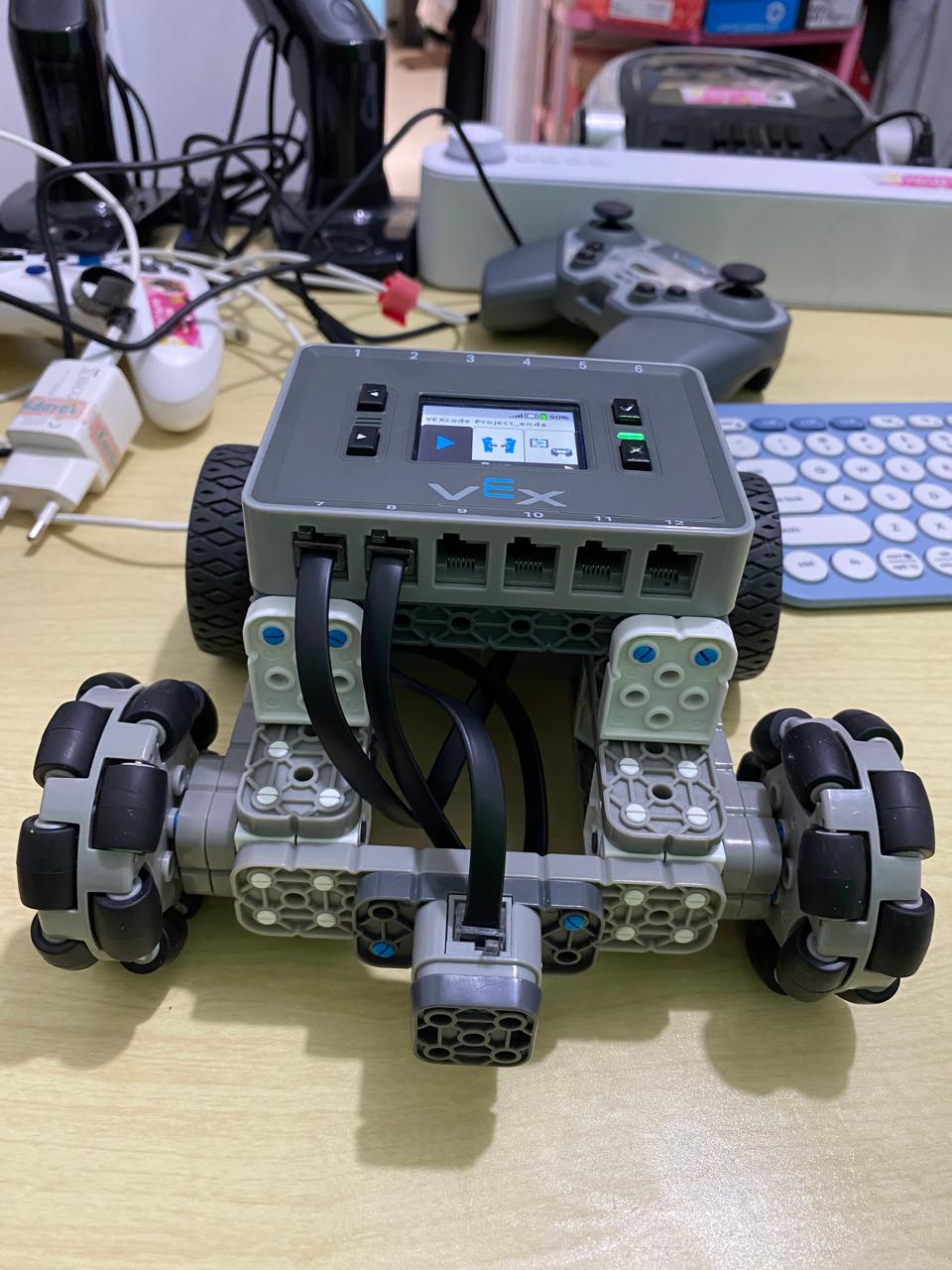

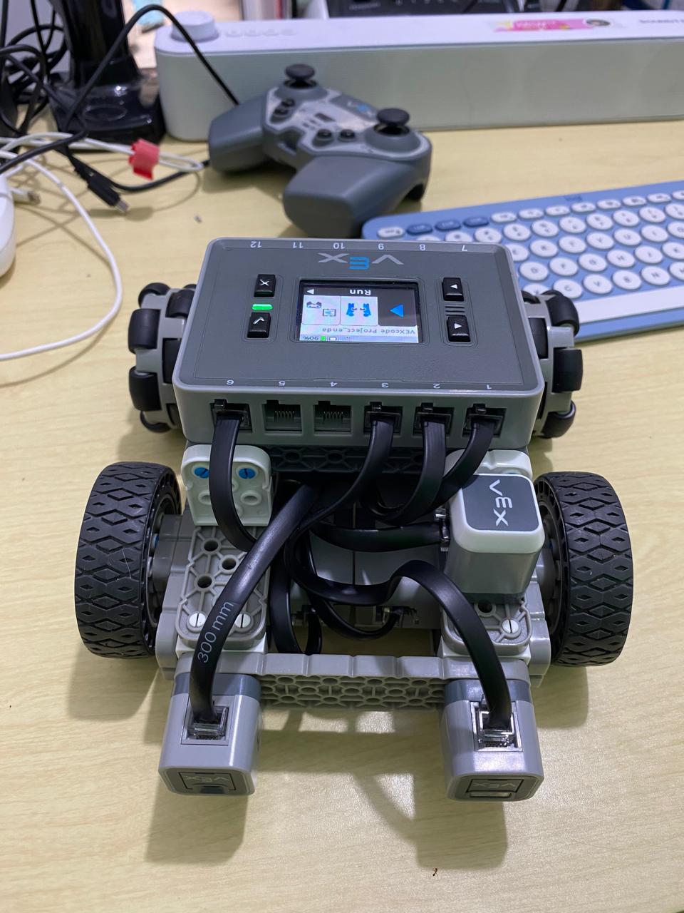

Hi everyone, I am a beginner exploring the VEQ IQ course. At first, I used the joystick to move the Clowbot and Basebot; everything went well. However, I found an obstacle when using the VEQ IQ app on the tablet. Every time I insert any block, it always makes the robot turn right. What should I do to fix it? Thank you for your help.
Here is the additional documentation, thanks!
Have you tried inserting a controller device into your code and then using the controller within the code to drive it? If it still turns when trying to drive forward, try adjusting the turn direction in the drivetrain device. Make sure to also make sure it uses split arcade for the controller device, which is obtainable by clicking on the joysticks. This helps because it ensures one joystick should theoretically guarantee a straight line of drive, instead of potential human error in tank drive.

This latest video makes me think that it’s an error in the drivetrain setup, as @imconfused speculated earlier. Can we get a screenshot of both of the drive motors’ setups? (One of “LeftMotor” and one of “RightMotor”)
It could also be a wiring issue, where the motors’ ports are swapped. Try to send a picture where the motors’ cables can be tracked to their ports.
Hi, thanks for following up on my issue. Here is the documentation for checking the cable motor and drive motors’ setups. Hope this is clearer: 2d_Checking cable port to motor and brain.mp4 - Google Drive
Great video!
It seems the wiring isn’t the issue. The thing that seems to be the issue is the direction of the motor, specifically the right one, in the setup. To fix this, go to the right motor setup page (you were on it at 1:33 in the latest video) and toggle the little slider just above the cancel button (make sure that it is now pointing to the right, towards the word reverse).
