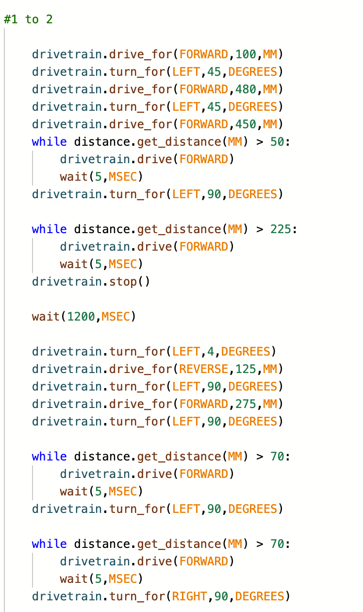

Hi,
My students coded with distance sensors, basic drivetrain commands and simple if and while loops, to accomplish the competition challenge level 1 of vex vr activity “number maze”. (Number Maze - VEXcode VR - Google Docs) Something interesting is the executions are not consistent. Only 3 out of 10 executions succeeded. The drawn routes of successful execution don’t look the same. The failed executions are different as the robot just hit random walls at various locations.
I guess the reason is the distance sensor. However what is the detailed reason? And how to solve this issue to make the execution consistent?
Part of codes attached below:

I would start by actually using the distance sensor.
Thanks for reply. What do you mean? Could you give more details?
There is nothing in that code involving the vision sensor.
I think the OP means using distances travelled, not using the distance sensor.

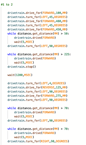

Opps… Wrong screenshot earlier. Here is one including distance sensor.
And here is a screenshoot of the executation. The robot just mess up here or there. Only 3 out 10 times can succeed in running through the maze.
