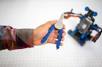

There’s a new Peg Puller tool that will be coming out soon, that should address that.
Source: https://blog.vex.com/2020/02/05/vex-rewind-january-recap/

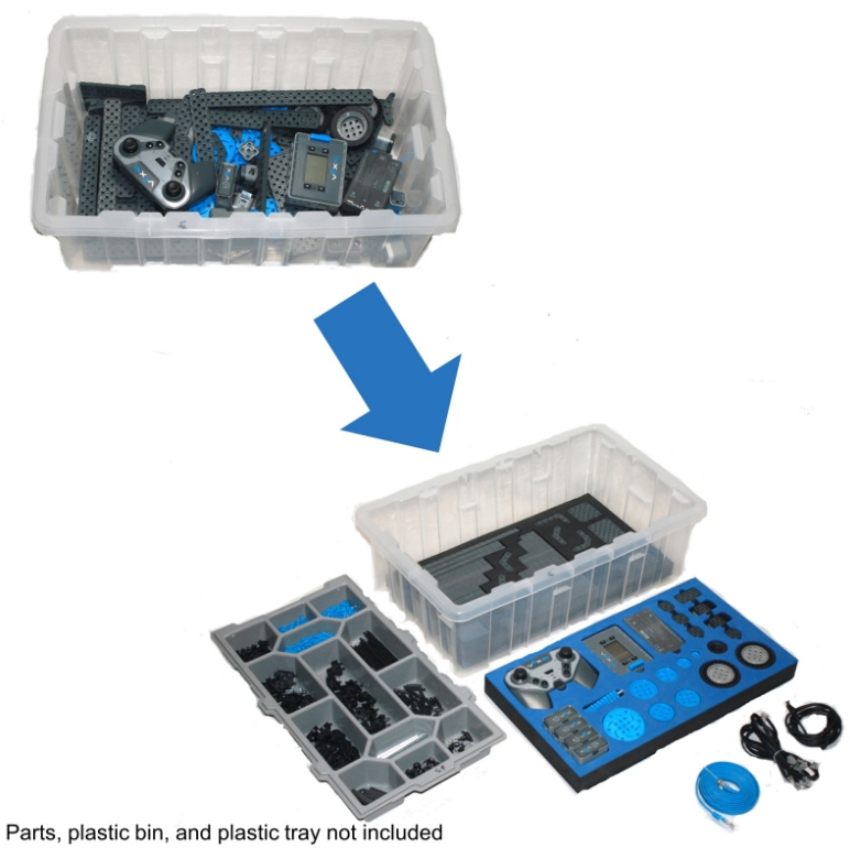

If you’re looking at keeping IQ Superkits organized, especially in a classroom setting where you want to be sure students have a complete kit to start the season, take a look at this organizer: https://www.robosource.net/vex-iq-related/430-parts-organizer-vex-iq-super-kit-foam.html
I love the foam organizer. It would be nice if they had spots for the first set of upgrades 90% of the teams make in Omni wheels. The other things I suggest to teams is one of the long beam pack, the advanced connector set and another motor.
We issue all our Virus teams a Foundation add-on kit, 2 more motors, and Omnis, with another custom cut foam organizer. But there hasn’t been enough interest yet to make them in quantity.
