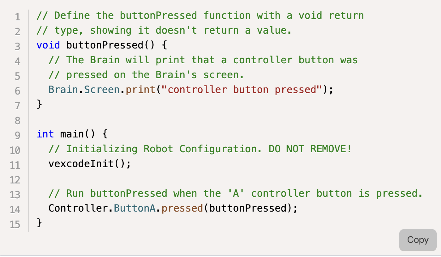

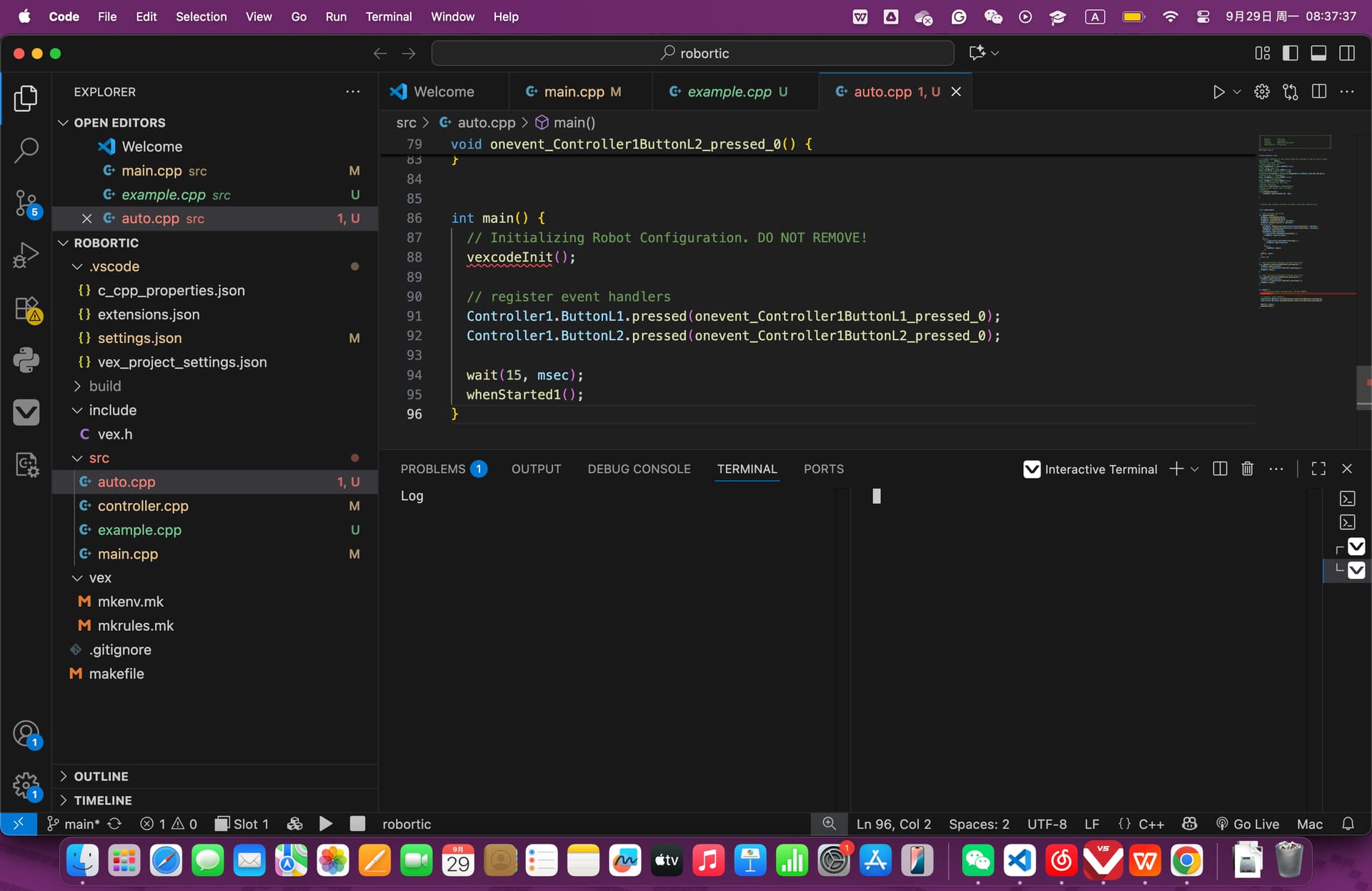

Why the vexcodeinit() sent a warning while coding?
vexcodeInit() only works in VexCode. It should be removed in a VSCode project.
Why on the library of vscode project, it says do not remove?
The reasoning is because it calls an initialization function inside of a robot config file. Here’s an example of a robot config file that I had a long time ago:
