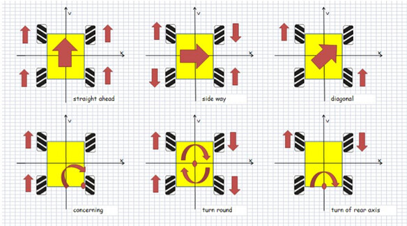

Mecanum drive is holonomic drive where four mechanum wheels are placed in a tank drive format. The wheels should look like this when looking from top:
Like all holonomic drives, mechanum bots can strafe, and does so with a simple rectangular base. However, mechanum wheels have rollers that slip, reducing traction and pushing power.
