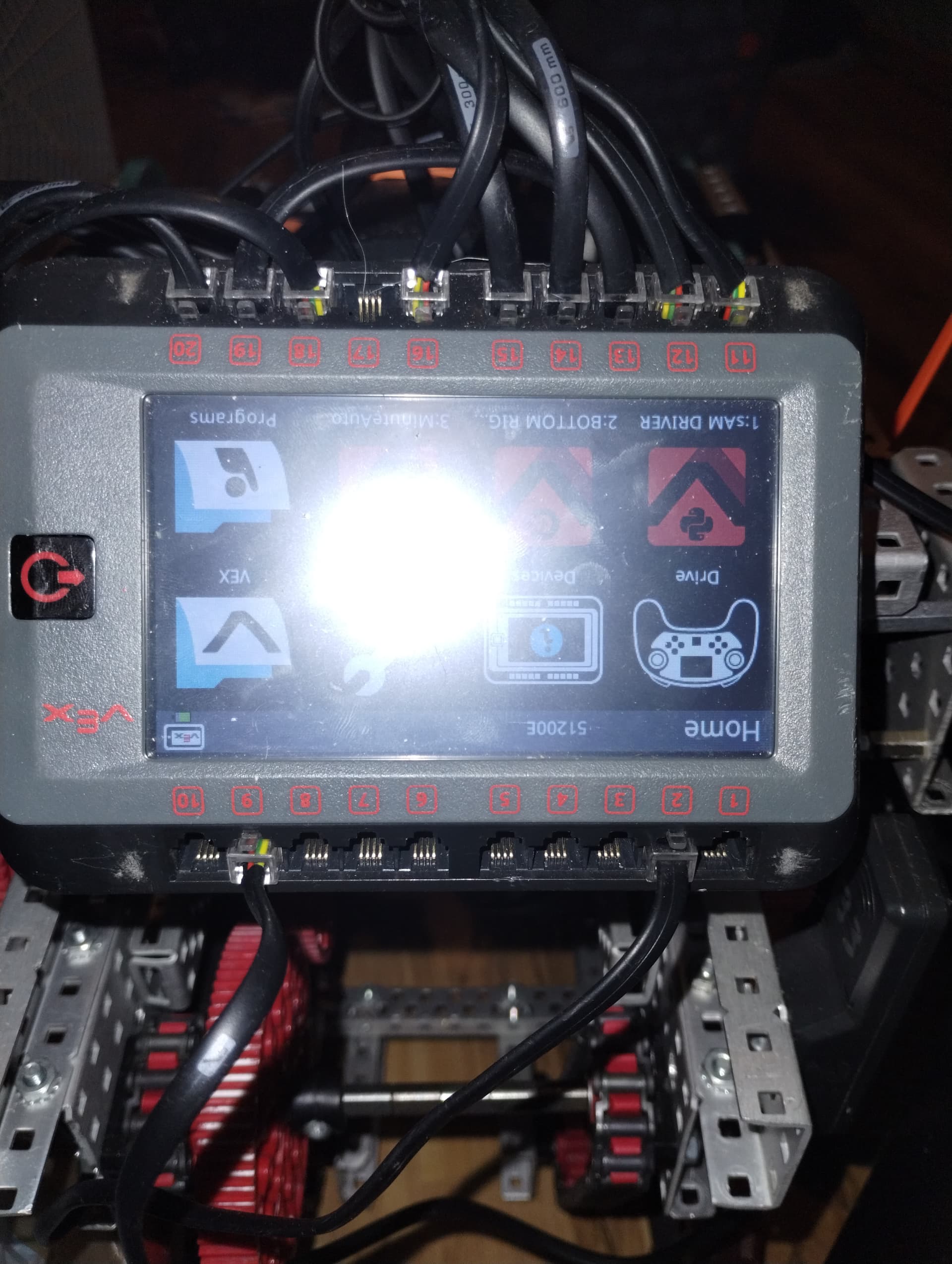

I’m using a microUSB cable to connect the computer to the controller/brain. I’m a new user so I can only put 1 photo per post, hope these help:
Ignore the upside down brain placement :upside_down_face:

You can go to Settings on the V5 Brain and flip the view right side up … :slight_smile:
