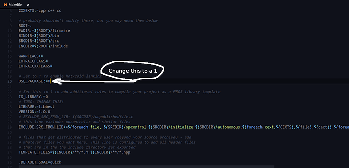

There is wireless uploading via the V5 Remote.
Then plugin your remote. Make sure that it’s connected to the brain. Then upload using
prosv5 upload in your terminal.
No, he already knows how to wirelessly upload.
Besides, that has nothing to do with wireless uploading, all it does is reduce the download size/time. Simply installing the latest CLI enables wireless uploading.

Yes, but if you don’t enable hot\cold linking it takes 2 minutes. I don’t know why it doesn’t work already, but it doesn’t. I want it to. Can @Electrobotz rename this thread to something more descriptive?
