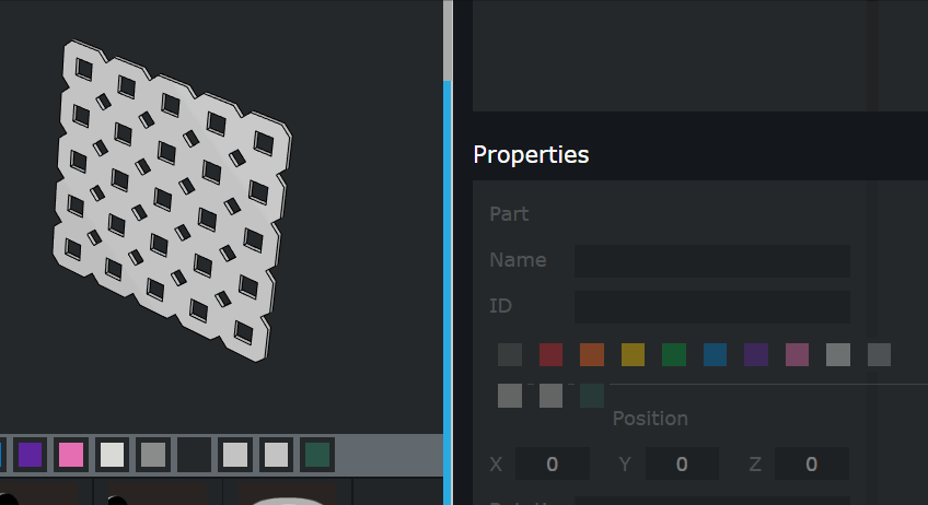

I see a color palette in the tool box, any way to change color of objects after creation?

Select the part, click the color you want to change it to.

Ah, it looks to be because all the wheels are solid and it’s a very light bot. If you swap one pair to omniwheels, it becomes much more deterministic. This appears to be a case of very light robot with very large conflicting forces jumping around, which is not terribly unexpected.
Whoops, sorry, bad UI choice on our part. To change the color of an existing part you select the color in the properties in the groups tab, not the color picker in the parts tray:
color
Oh… so sorry… never knew there is a “Group Tab”, never looked there. And parametric positioning?!? No more dragging and guessing??? I’m soooo stupid.
