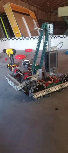

chain that is done properly doesn’t have alot of slop, especially the 6p IQ chain with larger sized sprokets. very good teams have done it. but yes it is definitely prone to breaking. some other issues is that it is harder to get very good drive train frictoin as the chain is usually barley to tight. although i havent noticed it to be a huge issue. i built a 360 RPM drive on 4inch wheels robot that used chain using 24t:40t over the summer for fun and i never had the chain break once through out about 24-36 pretty roughf matches and i never noticed any overheat issues due to friction. (we were in a shed that was around 95-100 degrees)
pictures kinda crappy but you can kinda see also dont judje BQ to much i built and tuned this bot in about 24hours using scrap parts
