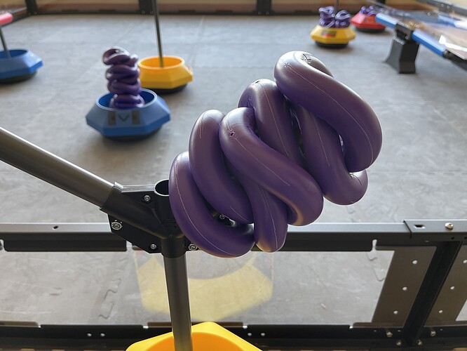

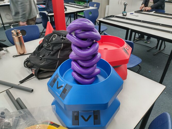

I’m hesitant to say how but we managed to fit 11 rings on the alliance mobile goal, and we did actually manage 5 on the branches where none would fall off

We were messing around and we determined the ultimate max ring count for branches is 7.
