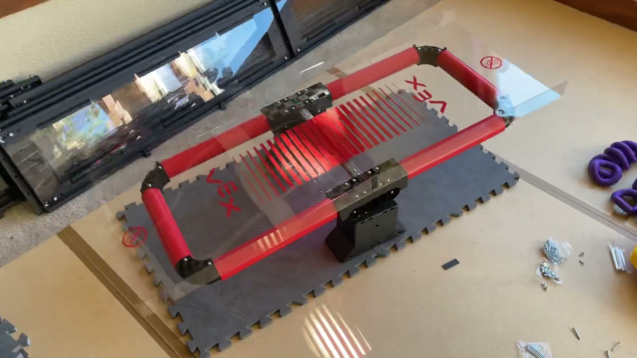

Can you send a video of how wobbly yours is? Like just push all the way down on one side and let go.
I’m not smart enough to post videos on the forums so check discord
Just upload it to youtube and link it here.
BAHAHAHAHAHA fair enough
Or use Google drive, or an unlisted youtube video, or a regular YouTube video.
Any other questions? Now I know I can also make videos to answer them.
Keep in mind the platform isn’t connected to the walls so it is slightly more wobbly than it would be.
I can also take a more clear video, I have all my tiles down now.
can you do another video?
this time with it all the way connected?
seems odd that it has so much wobble
Woe to the steel robot that breaks that
As always I’ll still take any and all questions :+1:
[thanks for the epic thumbnail, YouTube]
It still looks like you may have a bit more play in that Platform Base than is ideal.

We have the anti-static floor tiles, which may be thinner than the non-anti-static tiles and found we needed to substitute out the 3/4" standoff that goes into the floor plate with a 1/2" standoff. Would this be considered a reasonable assembly?

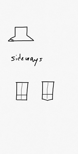

I’m probably overconfident but I’m not too worried by the wobble anyway,
I think the big issue is the molding of the box halves.
This is tough to explain so I drew a little picture,
Instead of being flat on the bottom, it reaches a tip (shown on the right) which I feel like is at least part of the issue.

I believe I have found the primary “culprit” of the wobble, and that is the plate holding the platform under the tiles itself. I know there’s not much to do about it but the plate creates a lump that the block sits on. Since this lump is in the center, there is elevation on both sides of the block and that means room for the whole thing to wobble.
Perhaps there can be an official addition that adds thin layers (like styrofoam) beneath both sides of the block to resolve the lump issue, I believe this would be the best solution to eliminate wobble.
