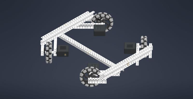

This is a design from Dennis on 81K. I made a quick CAD early in the season. It has some cool geometry and is pretty sturdy. I believe Dennis is still using it at this point in the season.
That is quite a very interesting design

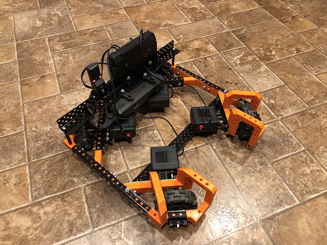

I whipped this guy up real quick a few weeks ago. Each corner is 3D printed out of PETG and is connected using C-channel. Came out really sturdy. Unfortunately the odds of me being able to compete with it under current circumstances are decreasing rapidly.

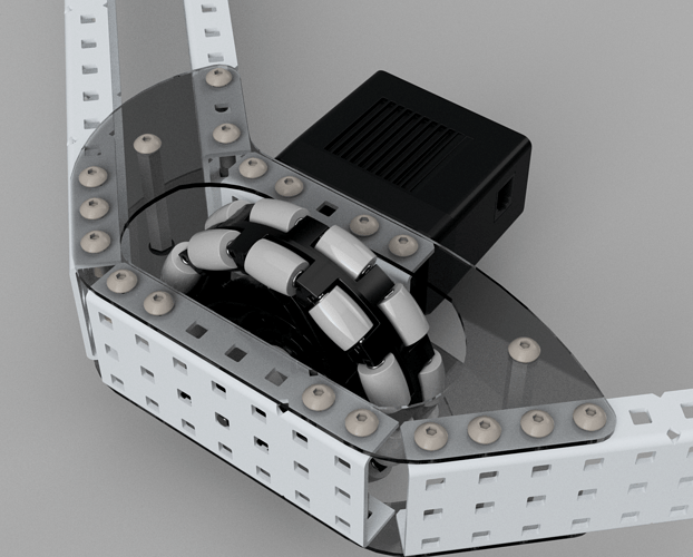

I made this in f360 over the weekend and I’m hoping to cut these out in a couple weeks.
