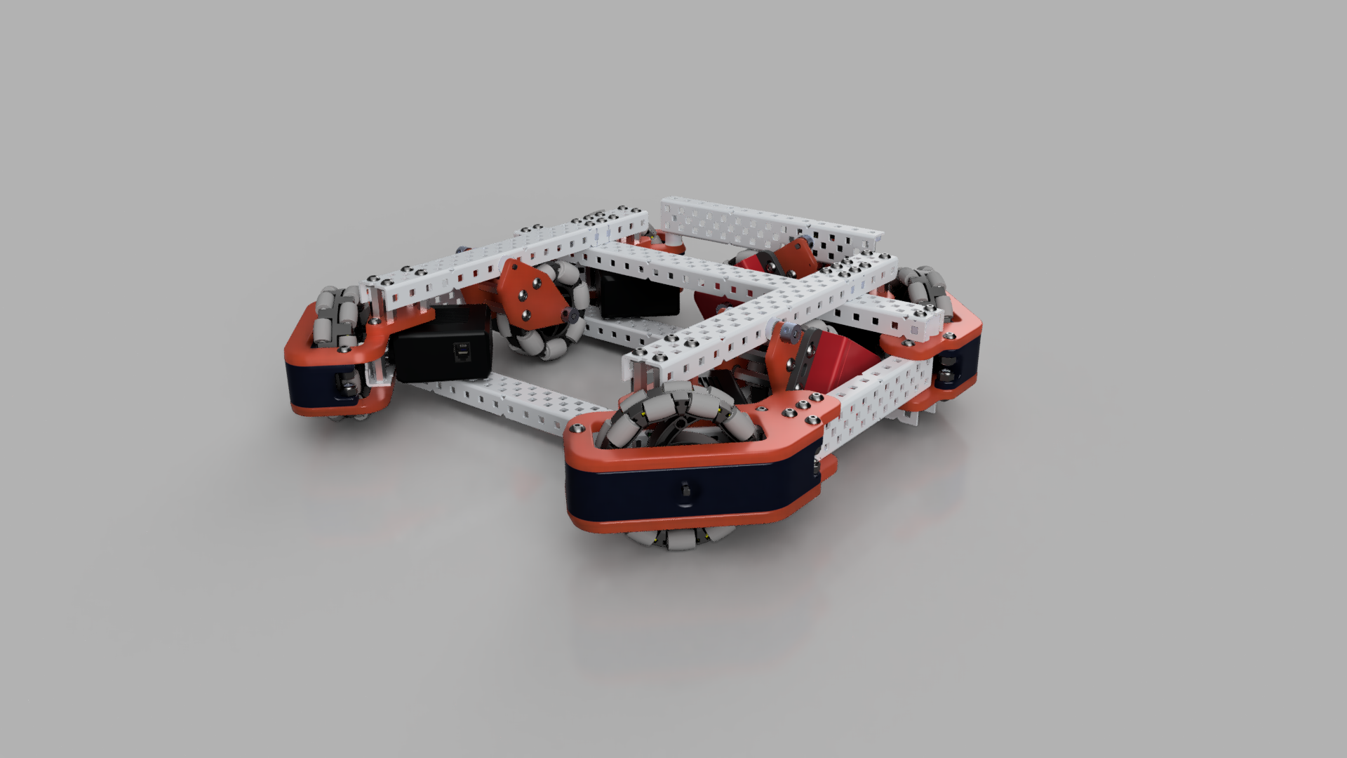

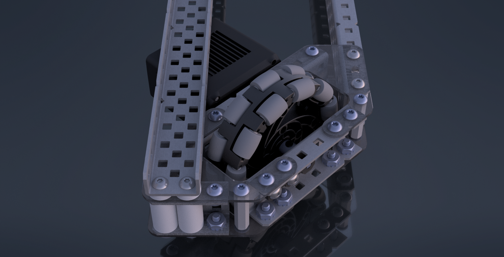

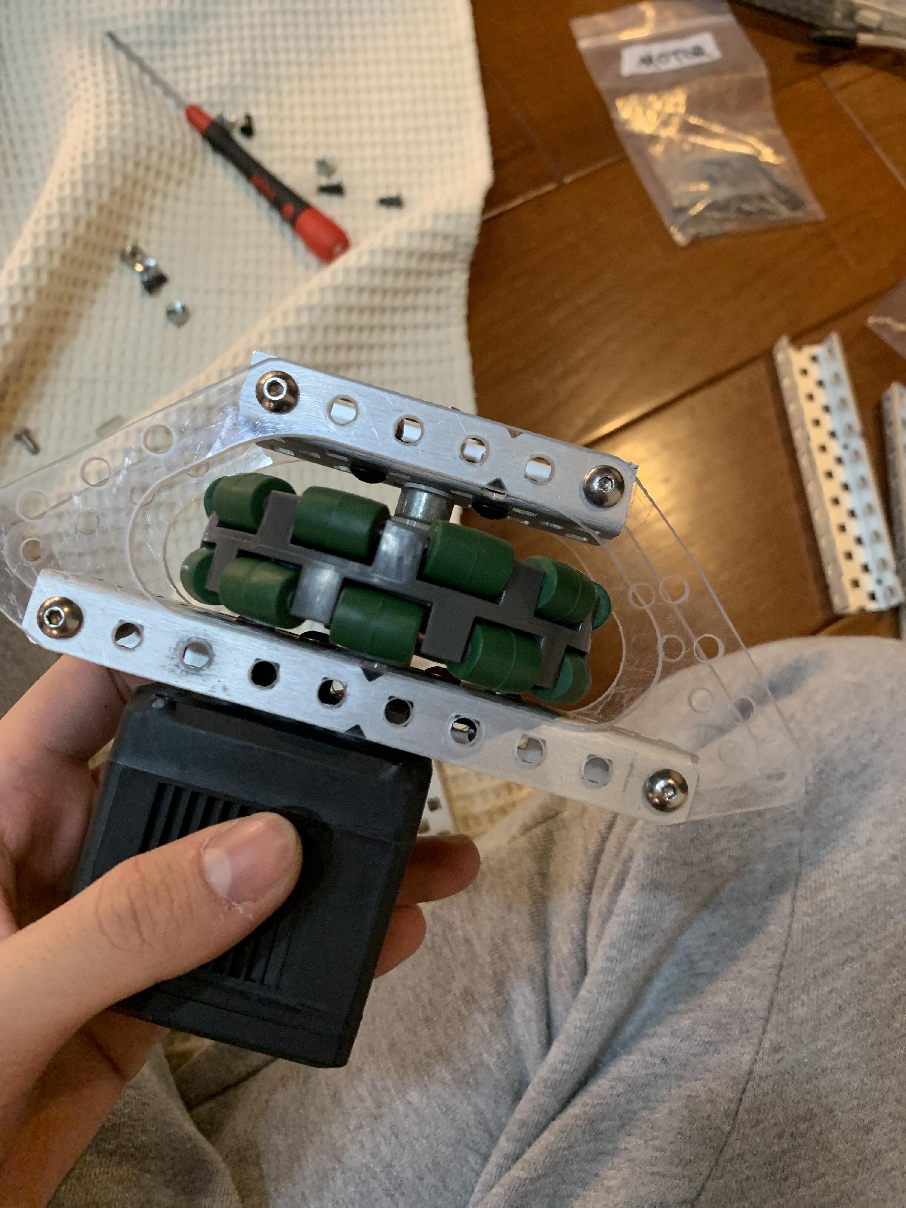

Based on the pictures here: X-Drive with Custom Gussets - #3 by vexreally and the next post by @Ethan5956F Plexiglass X-Drive Pods were thing for 2019-2020
Add in the CAD work by @vexreally Simpler X-Drive Design - #5 by vexreally (love the C Channel reinforcement) from this spring and from what I’ve seen from other team builds, they are still out there.
I’m still a fan of the old school 1x5x1 C-channel bases, but these new sleek designs are looking good. What are you building / have built for X-drive pods this year? What is your new snazzy design that makes you “Ruler of the X-Drive”? Anyone marry the ease of the custom plexiglass 45 gusset and the extra strength of Vexreally? Or have you enhanced the simplicity of @Codec’s design?

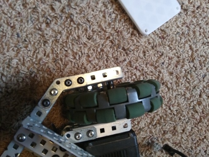

We still use the old way with vex 45 degree gussets. It’s simple and works well enough.

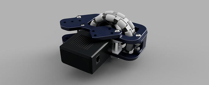

Here’s the full design, based on 5225a and 1961z.

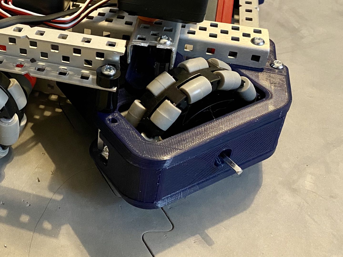

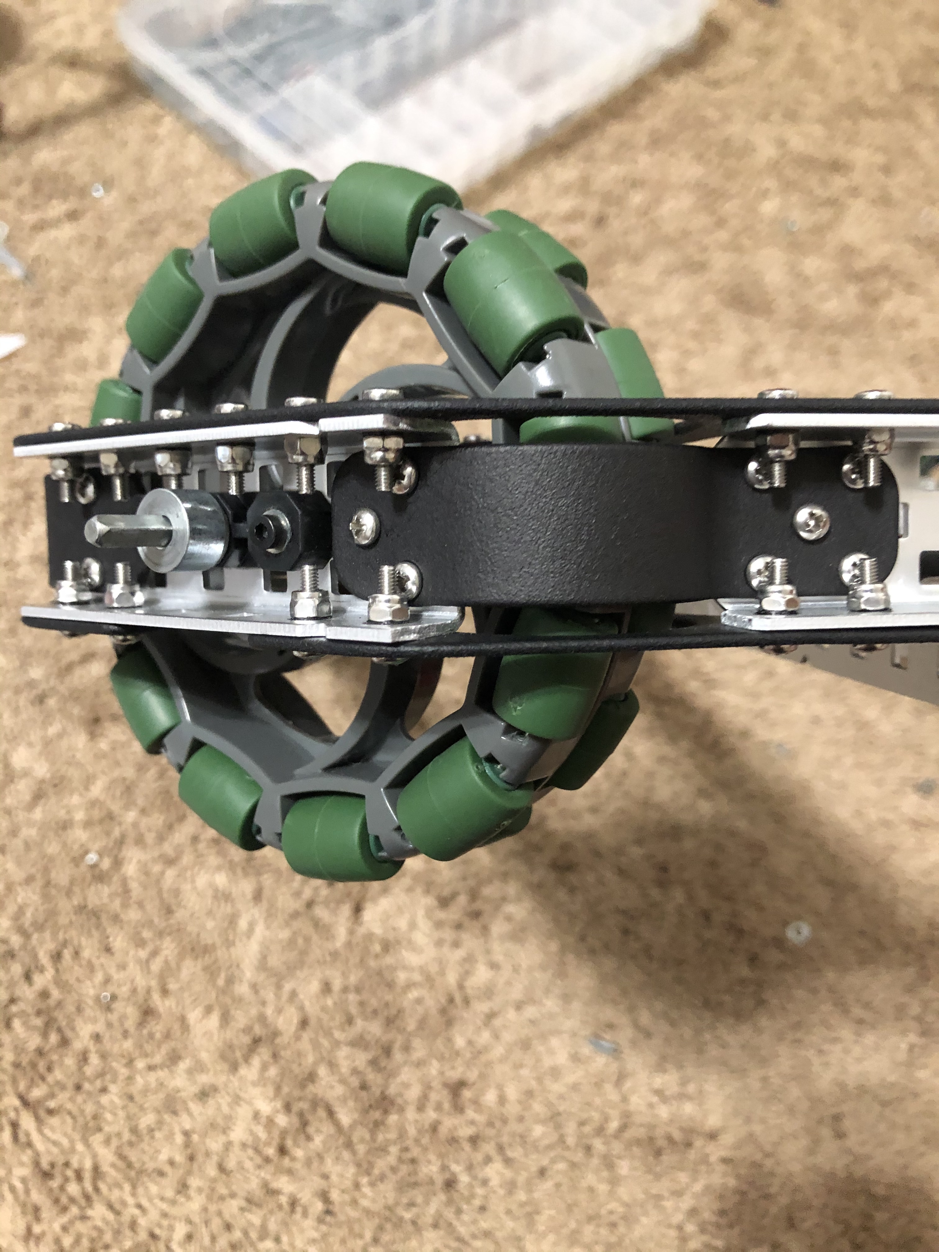

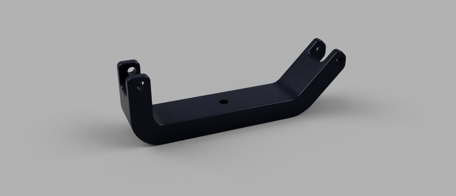

Here’s what I made for testing this year. Nothing special, but it’s one piece for extra strength. The hole can also fit a shoulder screw for easier alignment

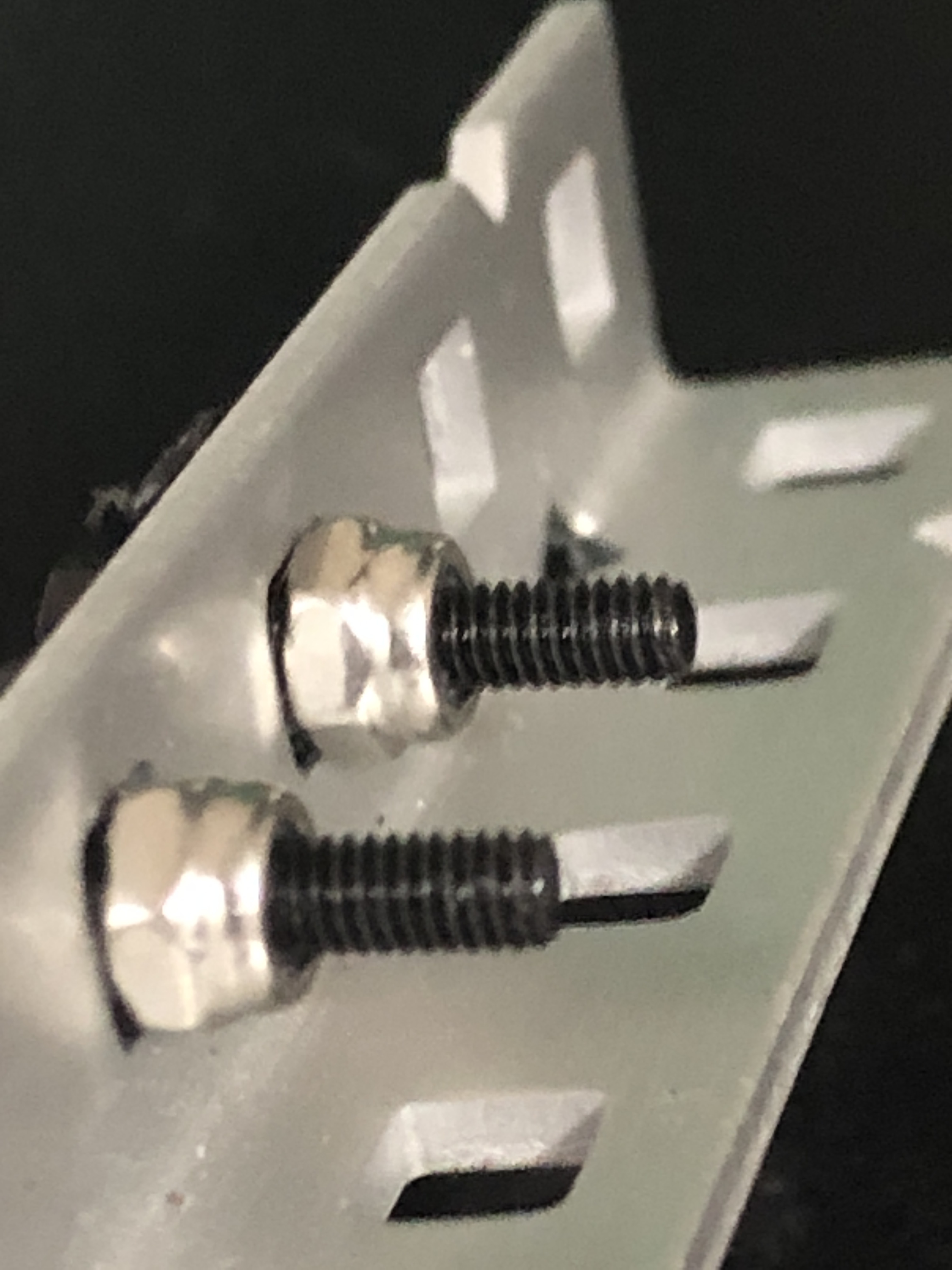

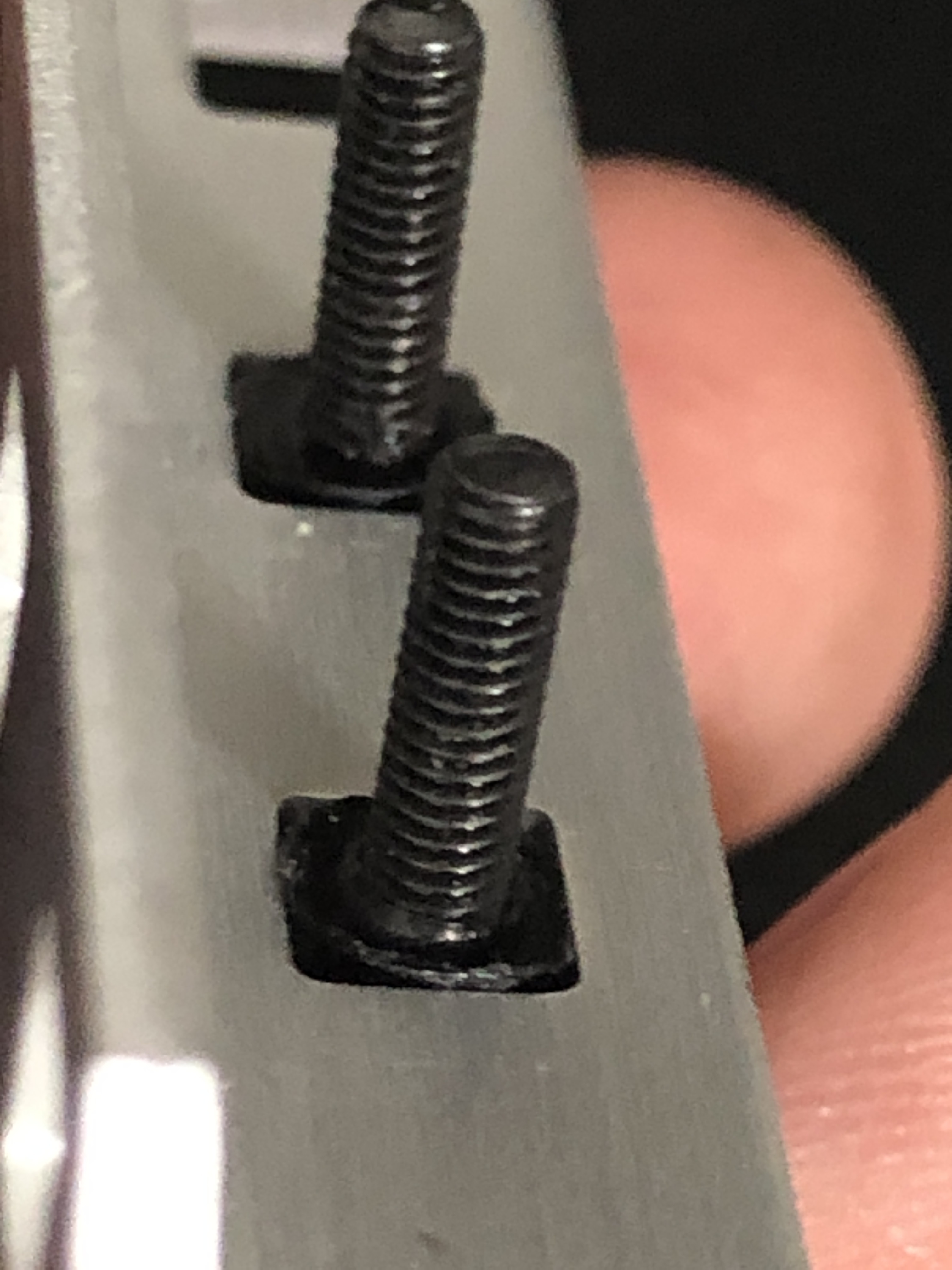

Also a question for @Ethan5956F: Wouldn’t using screws this small in size introduce a lot of slop into the system?
@sarah_97963A; Wow, that is pretty amazing. Thats some out of the box thinking. I’m sad that I only have one heart to give.
I see the piece of C channel on the inside for support, is there metal on the outside too?
@Ethan5956F Very nice, that is also a cool design. How do you get the curve around the middle support? Heat the plastic and then drape across a dowel?
There’s no c channel on the outside, it’s just another 3D printed PLA piece. I have limited metal for the 15" x drive, so I replace metal with 3D printed parts whenever that’s possible.

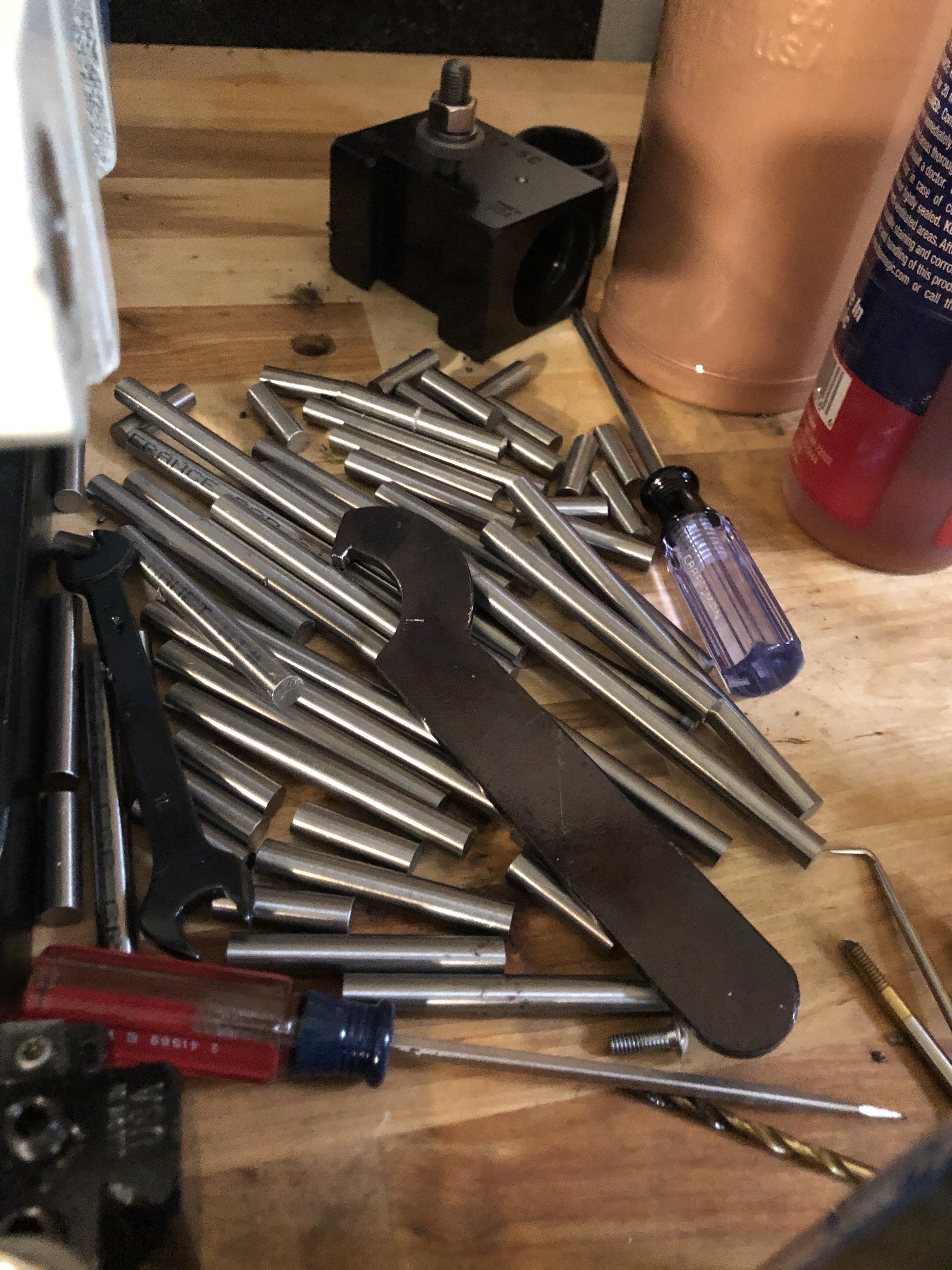

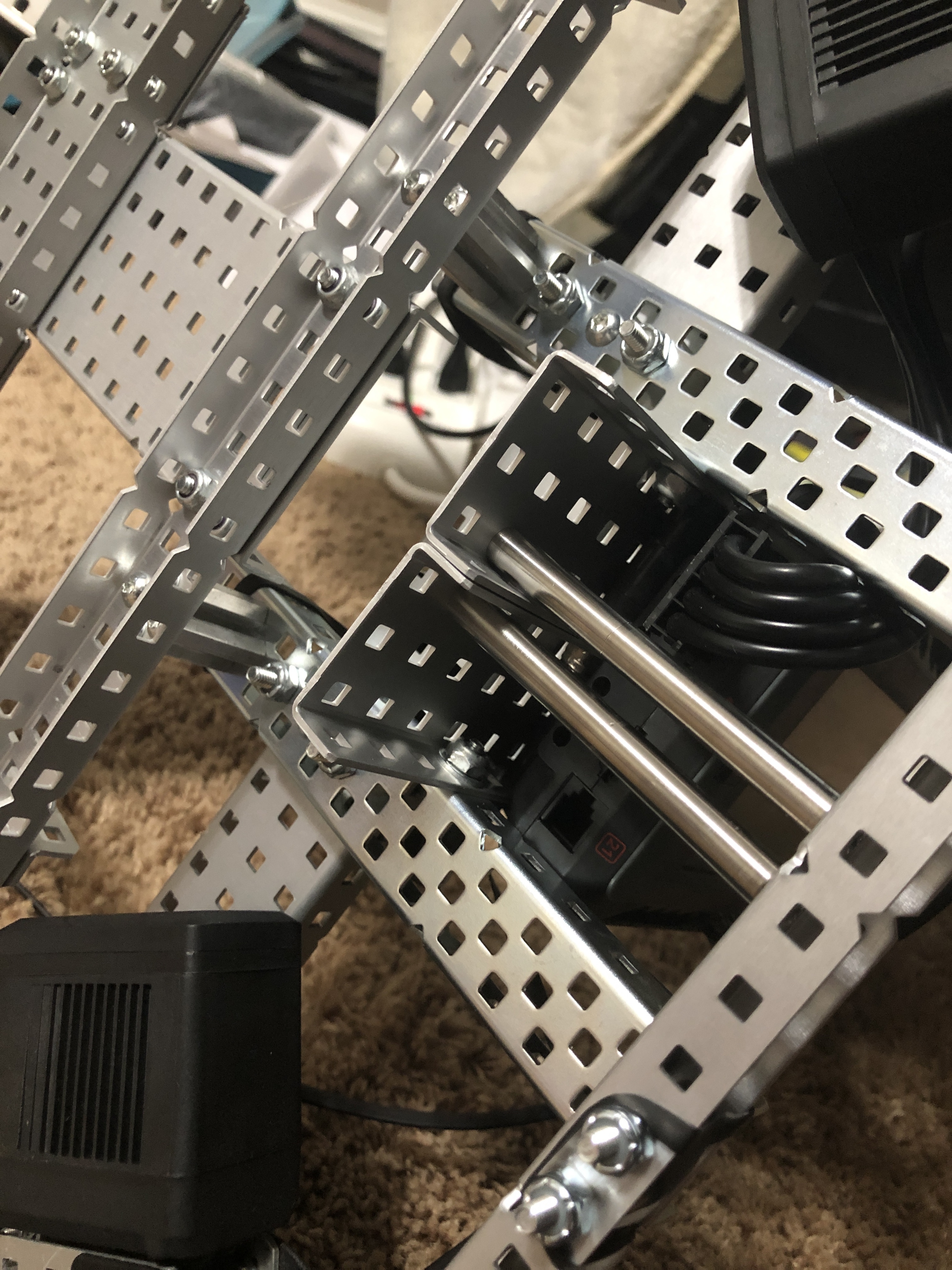

Good question! the reason I used those screws in the first place was actually to eliminate practically all slop from the system. Note that this was all done MONTHS before robosource shoulder screws were even announced- had I known they were coming I would have just waited. But dumb decisions aside, I made my own spacers with my lathe that threaded onto the m3.5 screws and allowed for a precision fit into the 0.182” vex holes. here’s a pic
One of the small black spacer is the same height as the c channel metal, and I can place them anywhere on the screw. It’s pretty cool but a lot of work (about 5 mins per spacer)

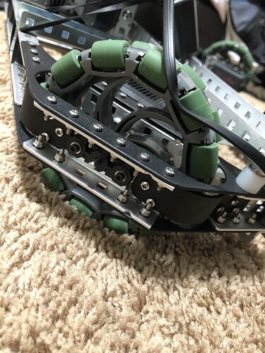

Thanks! No everything was actually milled from bars and sheets of nylon and then dyed black. The top and bottom gussets had some bending issues and i didn’t like how flimsy it was vertically, so i designed the side gussets to better handle the vertical forces and make the system more precisely constrained in that direction (keeps all the wheels exactly the same height)
They were meant to be high precision pieces, and unfortunately became unnecessarily expensive/complicated for something like vex. They worked great in the end but uh… i can’t say i recommend what i did

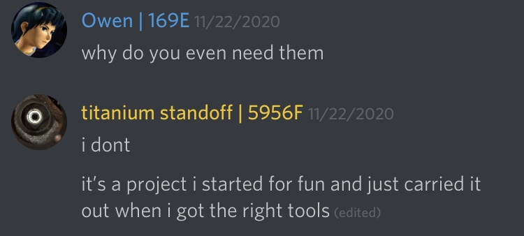

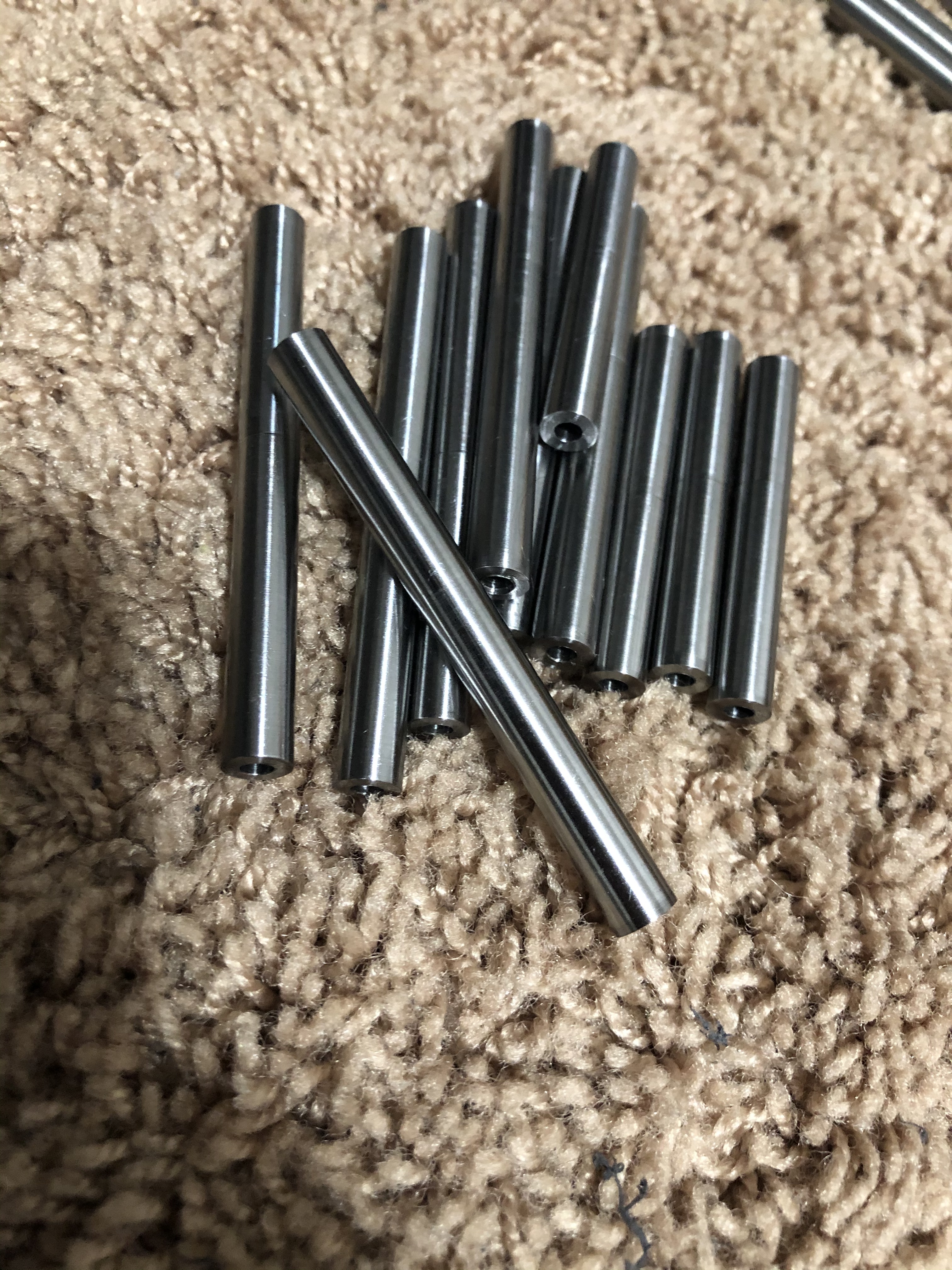

don’t even get me started on the titanium standoffs…
ok, but why?
I mean I get it, titanium, but I’ve never had any issues with standoffs bending or anything.
Imagine showing up to a competition and your opponents bot is made out of titanium.
nothing to do with bending actually. Ti6Al4V has 5 x the strength/weight ratio as aluminum 5052 (what vex uses for their standoffs and c channels), so it ended up being lighter than the alu standoffs and I made 109 of them. They were more of a fun machining challenge with my new lathe than anything

Thanks, @sarah_97963A I’m interested in how that holds up with the square shaft spinning in the PLA hole. I think I would have tried to get a bearing block inside there or one of the 1/4" spinning shaft (freewheel) inserts. Did you enter this part in the “Hey VEX I really want you to make this!” contest?
Due to the limited precision of my 3D printed parts, the hole is more like an oval than a circle. If I redesign this I would make it compatible with vex bearings or free spinning inserts.

Damn, that’s a neat method to reduce slop. rn most shoulder screw’s shoulders are not long enough if c channels are connected with spacers in between. Using this method can probably solve the issue since the lathed “shoulders” can go anywhere on the screw.
I’ll definitely try this out by lathing & drilling M3 spacers into M3.5 x 0.182” size.
