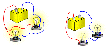

Here’s an image of two batteries powering two lights. The left one is parallel, the right one is series.
The main reason the right one isn’t as bright is because it has two resistors, and the circuit on the right resists 2x the amount as compared to the left, making the left parallel circuit be brighter.
