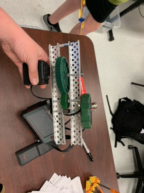

our team is using a 7:1 gear ratio with a 84t to a 36t to 12t gears which all run pretty smoothly and can get up to 4200 rpm
(old photo will get a updated photo later)
This is good if your using a 3inch wheel but if your using 4inch 3000rpm (5:1) is alot better
Ok I’m assuming you’ve done all this I’m about to saysince this is an old photo, but:
  1. Needs support on both sides of the c channel. I would suggest having the c channel flipped over 90 degrees either way from where it is now, so you can put four standoffs instead of two to increase the quality of the flywheel. You wouldn’t want to sit on a chair with two legs.
  2. Should use shoulder screws on the stand-offs. They increase alignment by a lot and single handedly made our flywheel work. Definitely an essential for a consistent flywheel. If you don’t have them i think there’s other methods to do alignment.
  3. Needs 2 bearing flats per axle: you have no bearing flats, and I’m assuming you’ve put them on already but just in case you greatly need that.
  4. Needs an extra c channel with a bearing flat to support the wheel. Use shoulder screws to attach it.
Dont know about the quality of my flywheel, but i think it’s good. Ignore the uncut metal.
Note: there is bearings for the axels they’re just hard to see.

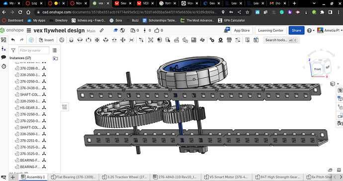

thanks and yes i have done most of those now side note what cad are you using?
here is the cad
why do you have a 36t gear in between the 12t and 84t?
its an idler gear just to transfer motion
Also sucks up some power due to shaft/bearing and gear tooth friction.
if your just doing 1 motor then you either want 3000 rpm or direct 3600 rpm. 4200 would probably have issues when running off of 1 motor. Personally I would suggest 3600 direct as it has very little friction when compared to other designs.
