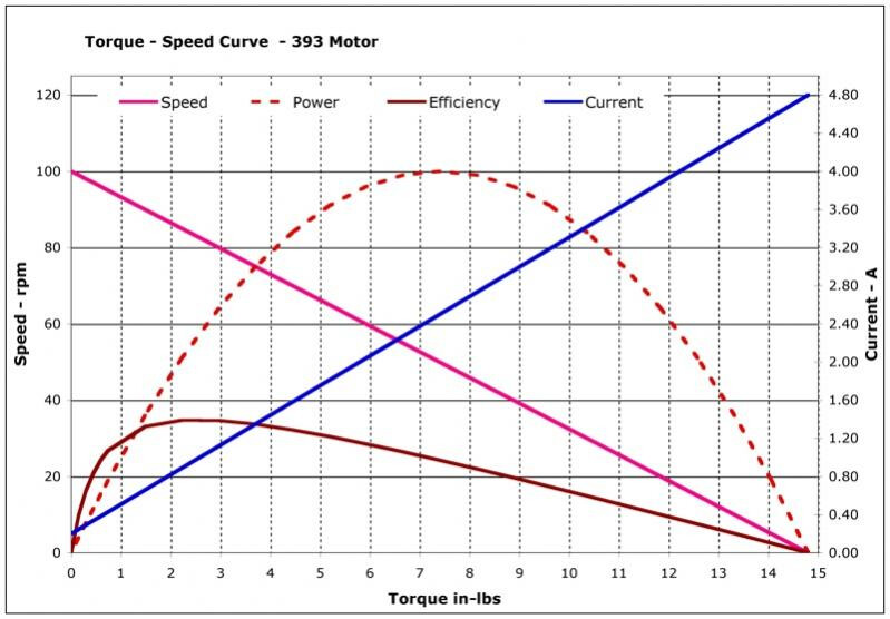

Here’s the problem. Below is the theoretical torque speed curve for a 393 motor, notice that stall current is around 4.8A. Now to protect itself the motor has a resettable fuse known as a PTC which will after a few seconds disable the motor, but for at least a short while it will pull lots of current. At maximum motor power, the motor is still pulling over 2A, this is all at battery voltage of the cortex which was 7.2V.
The 3wire device cannot provide 7.2V, only 5V. It also is limited to 2A maximum for all 8 ports combined. You can see that’s it’s not really intended to drive motors. So you could use a 3wire expander, but it will also be limited to 2A.
